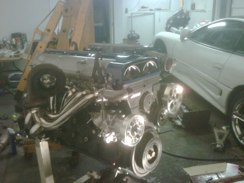

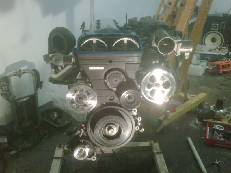

Forgot to recharge the camera again, some shitty cell phone pics for now.
Motor is ready, just need oil pan and motor mounts!

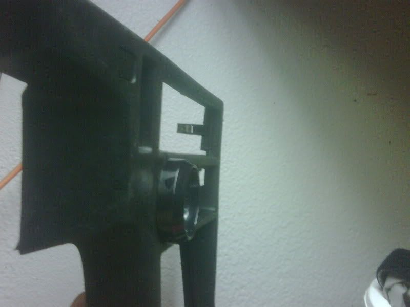

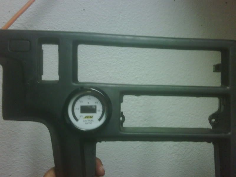

Got my wide aem wideband in finally, I cut out the cig lighter and installed the gauge there, much nicer i think.
Again sorry for the shitty pics, this damn camera is acting up :/

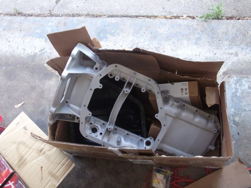

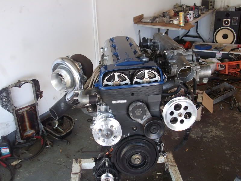

Got my rear sump oil pan setup, waiting on the rear main seal to arrive before i can install it.
Bead blasted, Welding a an fitting for my drain tomorrow.
And better pics of the complete motor minus the oil pan.

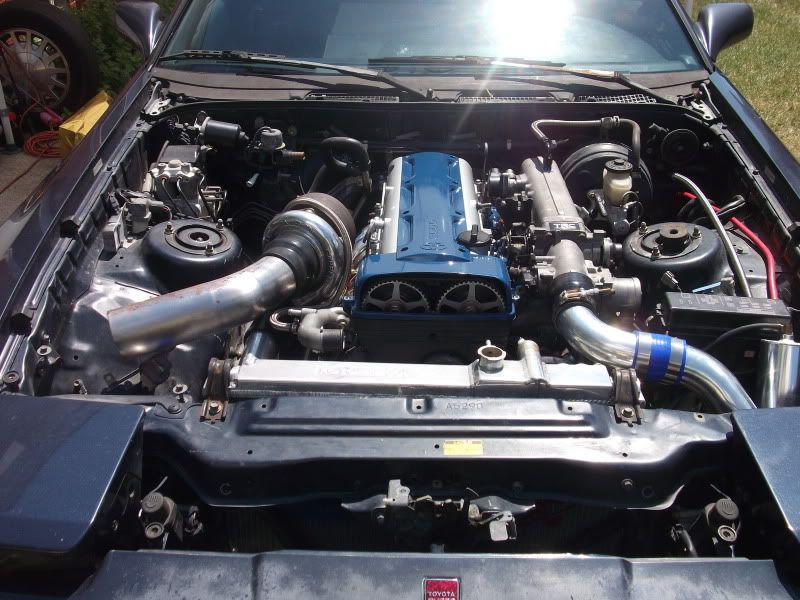

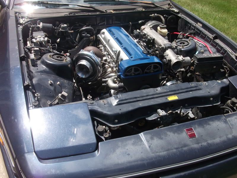

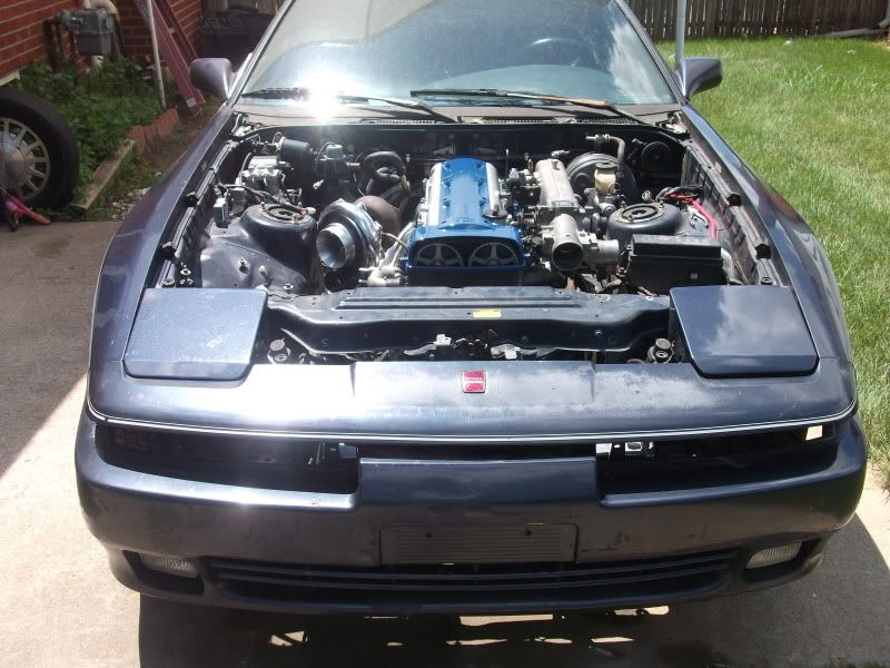

Ok well it seems like my trans guy is really taking his sweet time and might not be able to have my trans back for the MI2K11 meet which sucks.
But in the meantime, I have the engine in the car as a mock up. That way I can run all my IC piping, and my fuel lines so when i do get the trans all I have to do is pull the motor out, connect the trans and drop her back in and just hook everything up.
Here is a couple pics, **reminder the turbo is not clocked the way i want it to be** More pics later

A bit of advice. You know the trans does pull back the motor which can throw off the intercooler piping. Just make sure you take that into consideration so a coupler can compensate for it without being stretch too much.
I am sure you probably know this but I just posted it because I know we all hate fitment issues.

Thanks for the heads up, I had that into consideration when I receive my pipes :D
