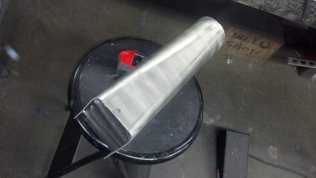

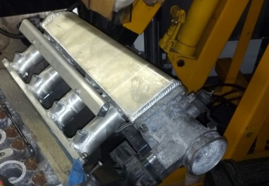

I dont have pics anymore, but I made a plenum that welded to the stock runners, cleared the alternator in the stock location. I rotated the T/B 90* so the linkage was on top and remounted the rod/linkage to the top of the plenum. It retained cruise, and the stock IAC (I would leave that, even standalone guys should use that). I did not use the CSI and only took a few extra cranks in the morning to get fired up.
I ran a front mount IC and was able to use 90* bends and couplers to go between the radiator and engine. I used some 3/16 plate for the plenum wall and press broke an 1/8th inch plenum that went from square up front to round out back. Never dyno'd, but looked trick and seem to pick up power up top.
Edit: I found the first one I did, and uploading the plenum style of the second to show you.
nathaninwa
Jul 1, 2012
377
Aberdeen, WA

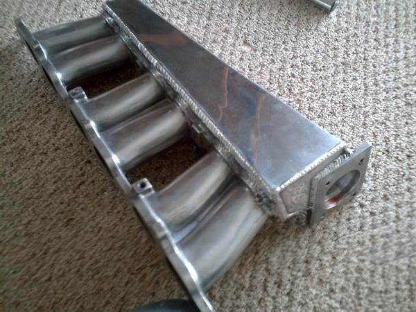

Heres the new plenums I form for t/b that are square to the bases. But others will get a flat plate and a D shape depending on the radius.
Just to give you some ideas.
Its also nice to get some stacks on the inside to pick up the air off the plenum wall.

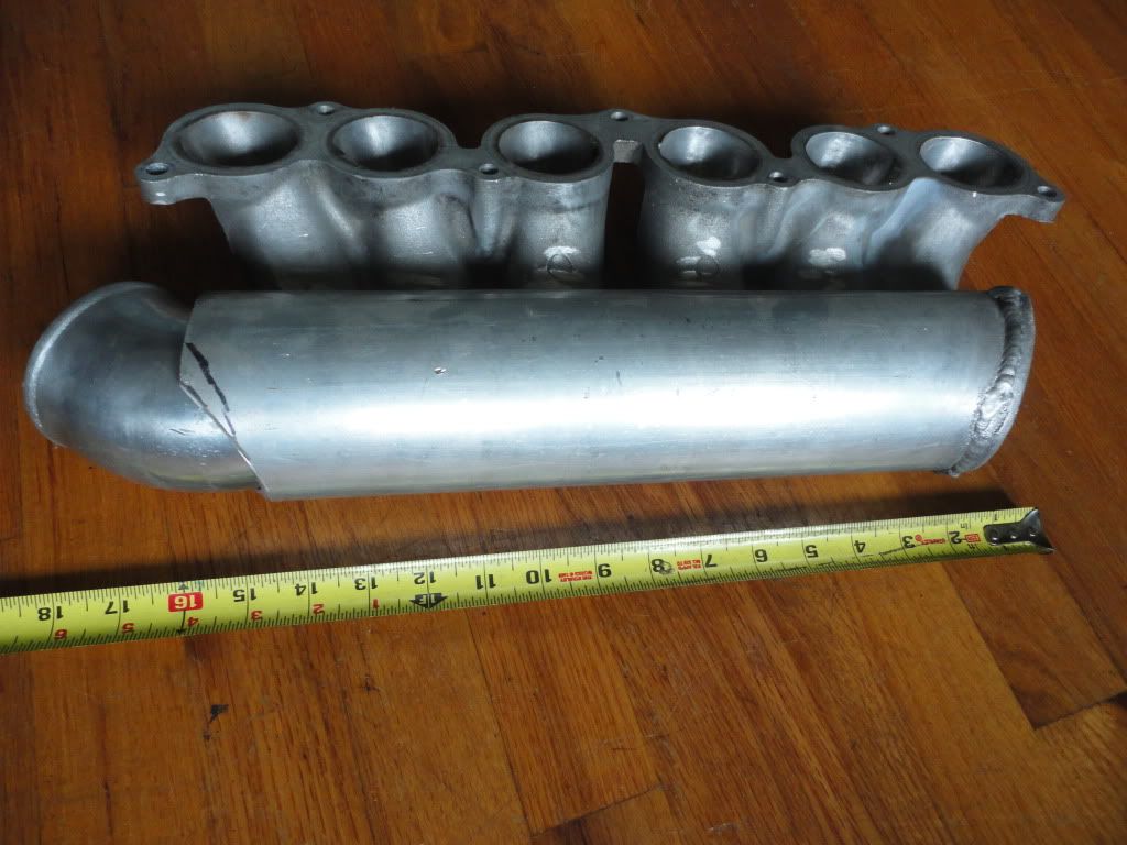

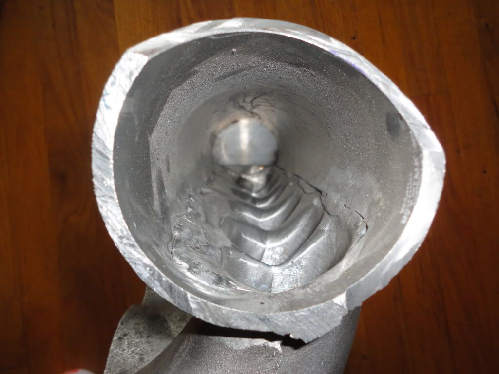

heres how i did mine for my ffim for my na-t 2jz. i have a 7m tb on its side with the stock cable cut and the cruise control cable crimped on to in. i made a little piece of aluminum where the stock cable adjuster sits. works really good. its nice cause the way it opens with it on its side directs air towards the front cylinders at part throttle which helps because the ffim inherently directs the air to the back cylinders somewhat. and my ffim is made from 1/4 thick 4x4 aluminum tube that was welded with a spool gun so its very strong. also made a support that bolts to where the lower runner had a support stock to the motor mount. don't want any cracked welds and want it to last for a long time.
this is the first one i made. i blew it trying to make it before having the motor in to make sure it would work. it sat so to high to where the hood just wouldn't close. i tried cutting part of the end of it off and puting a 45 on it but it was hopeless....ended up being a gigantic paper weight lol
