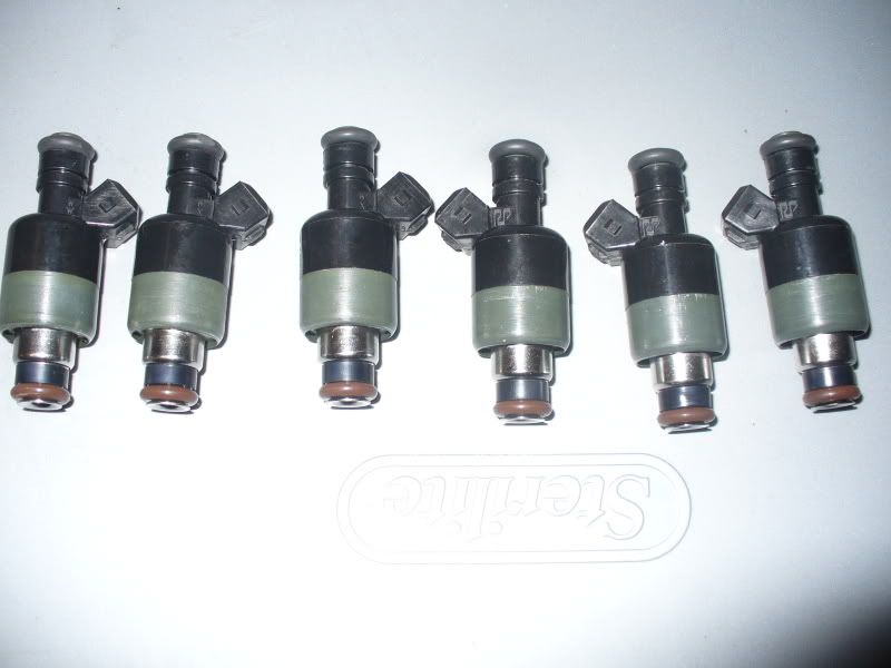

Edit-anyone know if MKIV top-feed (used with aftermarket MKIV rails) injectors will fit in the lower intake? Found a deal on some Delphi 880s but wasn't sure if they'd fit...

Sweet, read somewhere that domestic injectors were 14mm and the 7M/GE needed 11mm but I can't find the thread.
Here's what they look like:
Guess I can just run 2 7M grommets on the lower end like on my RX7 injectors, just wanted to make sure they'd fit in the rail

I ran domestic injector on my 2JZGE, they were the only injectors I ever put on that did not have any leaks the first time. I had a horrible time trying to get the Lucas/pte injectors not to leak. I think all I did for the domestic injectors was double up on the fuel rail spacers? I had some laying around from a 7m. It's hard to remember.

Sweet, there goes some more money into the Supra :) I've already got doubled-up spacers and lower grommets on my RX7 680s so I should be good to go.
