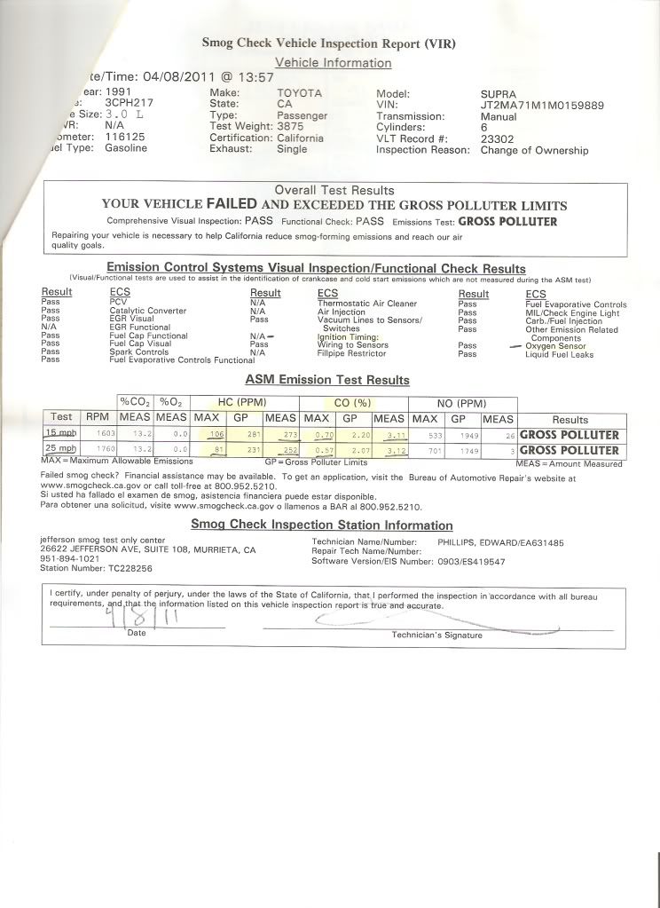

Save your money on the O2 sensor, you're car is running stoich and is in good fuel control. A/F at 15mph 14.643, and 25 mph 14.701. I presume the precat is gone on this car.
I would try fresh oil, a long high speed drive before the test, and avoid long idling time before the test. Put the timing back to stock.

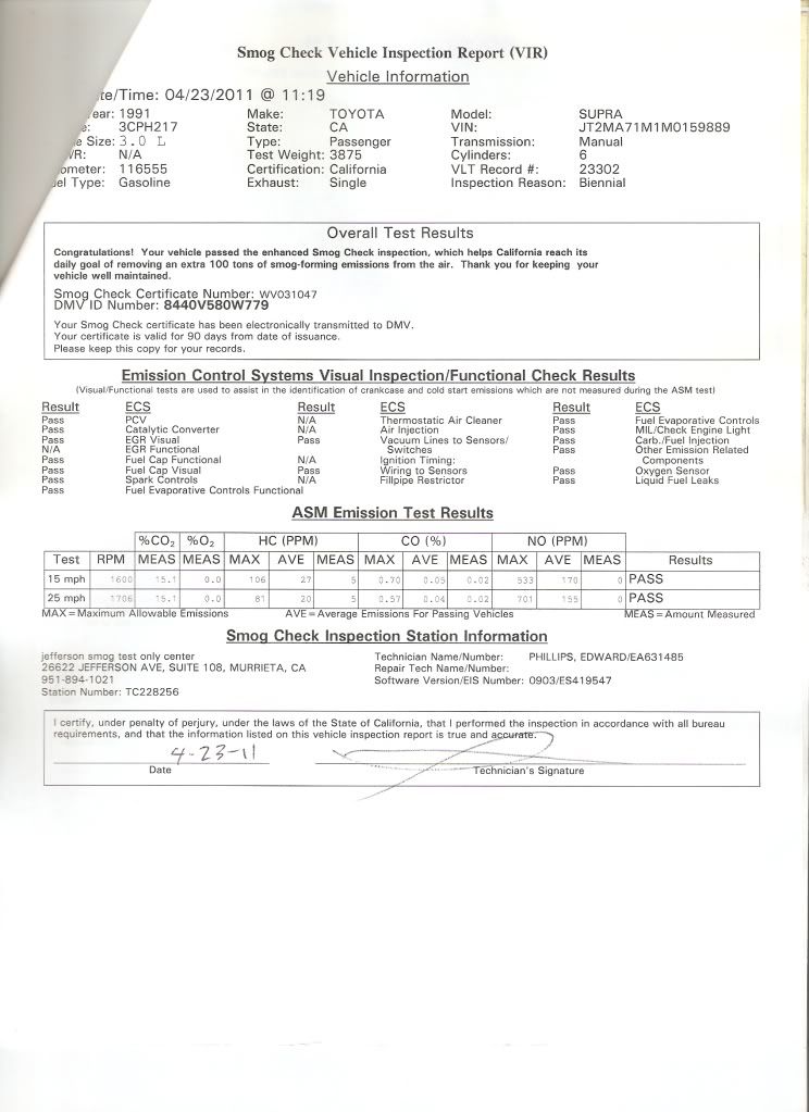

Maybe all I need is a longer drive then.. Yesterday before my smog I installed new NGK Iridium BCPR6EP-N-8 plugs and gapped them accordingly to my application. Unfortunately the only closer to stock exhaust I have left are a tanabe DP with a stock elbow.
Side note: Check out my smog report 2 years ago with the same car with stock exhaust(pre-cat included) and same smog test only shop, notice how the max values have changed...(fuck CA)
(would have passed if standards were same as below test)
and here's my last failed smog so you don't have to scroll up to compare:
(15mph = 1693rpm 25mph = 2685rpm)
