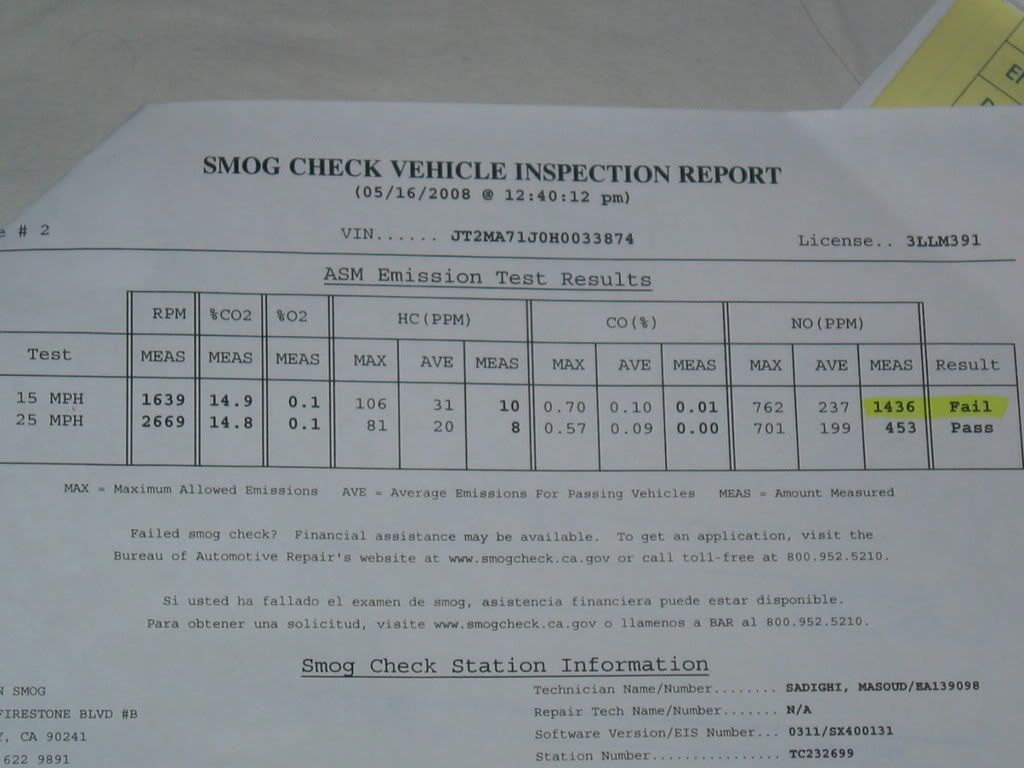

Alright, I took it in and had it tested for the third time, after bypassing the EGR VSV (wasn't functioning) and just ran manifold vacuum straight to the EGR Modulator (not sure if that would cause a problem). Well this time, the car half-passed the test. It passed the 25MPH test, but not the 15MPH. :(
I just installed a fully functioning EGR VSV to replace the old one...would this allow me to pass the next test? Or does the valve just open when the car reaches operating temp?
Here are the test results. So close!!!

I wouldn't exactly call twice the cut point close.
All the valve does is disable EGR at certain times, none of which occur during the conditions under which the test is performed. Therefore installing a new one is the same as bypassing it and will not effect test results. You have other problems. I'm guessing insufficient EGR flow from either a clogged passage or faulty modulation. I say that because although the 25 mph passed it's still higher than what I'm used to seeing on these cars and, as you can see from the report, higher than state average.
Unlike the first test your engine is now in fuel control. The cat is also working well. Prior to that you had a classic case of high CO suppressing NOx. Makes me wonder how long you drove it like that. Rich mixtures are what crap up EGR passages. Think about that next time someone tells you narrow band displays are worthless light shows.
