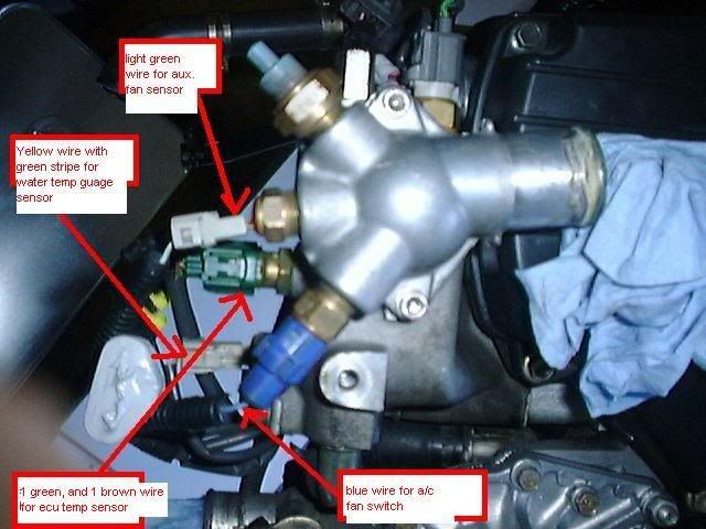

All the others are fine to replace, just make sure you replace the right sensors. One of the sensors on the t-stat housing is for the gauge while another is for the ecu. Don't remember off the top of my head though.

if u need it :)
jdub
SM Expert
Feb 10, 2006
10,730
Valley of the Sun
That pic says it all ;)
The "sensor" at the top (not labeled) is the CSI time switch. The ECU does get a signal from the oil pressure sensor...it's used to control the ISC mode. You will need to use an alternate location for an aftermarket oil sensor.
