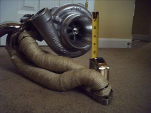

Any hints or tips on using exhaust heat wrap. I have an HKS short runner manifold that I want to wrap.
1. Hints/tips on wrapping?
2. Do you have to spray the manifold before and/or after wrapping with the material with Hi-Temp silicone spray?
3. What length will I need? Will 25' cover it, or should I get the 50' roll?
4. Pics of your project
5. Black or white color wrap?
