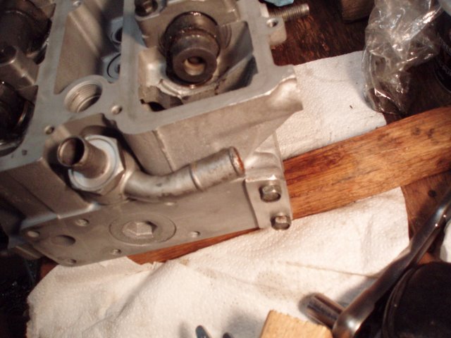

Check the egr cooler. its on the back of the head, near the firewall. I had this problem and it was coming from there.

yeah its not fun. ratchet wrenches are your friend with this job. lol. I thought mine was coming from the manifold as well. I even went as far as replacing the manifold and turbo gaskets and having the manifold milled at a machine shop and it was still doing it till I fould the bottom of the egr was leaking. Not a fun day.
