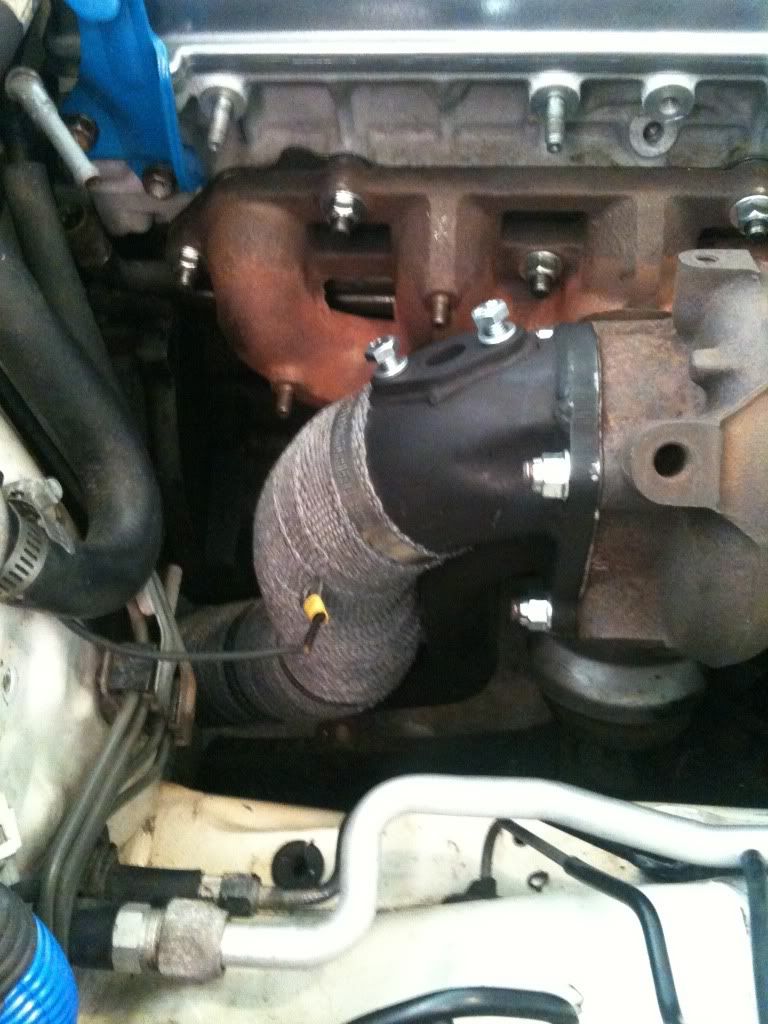

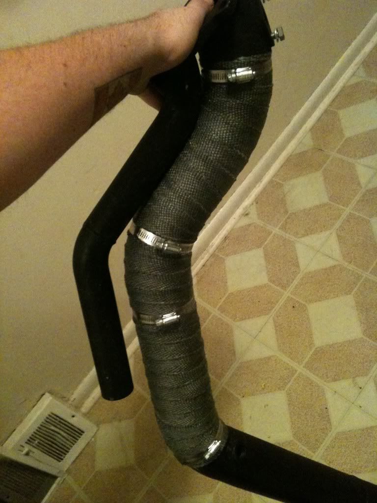

gaboonviper85
Jan 13, 2008
3,236
Northeast Philly
The downpipe is pretty much the most important part on the exhaust system...it's what makes or breaks power...this is my downpipe (BIC divorced downpipe)
expect to pay about $450 for one...not cheap but work great and sound even more badass.
