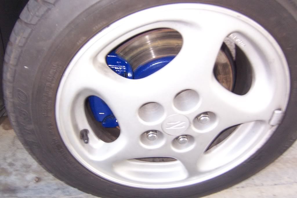

PlatinumTracks
Dec 8, 2008
90
CA
here is how they came out.... if you were wondering....
streetracer_258
Powertrain Engineer
Sep 1, 2009
26
Nottingham
Came out nice, personaly i would have painted the part on the discs black if at all. I used VHT exhuast/ caliper paint an it doesn't look as good. Probably will go over with engine lacquer.
