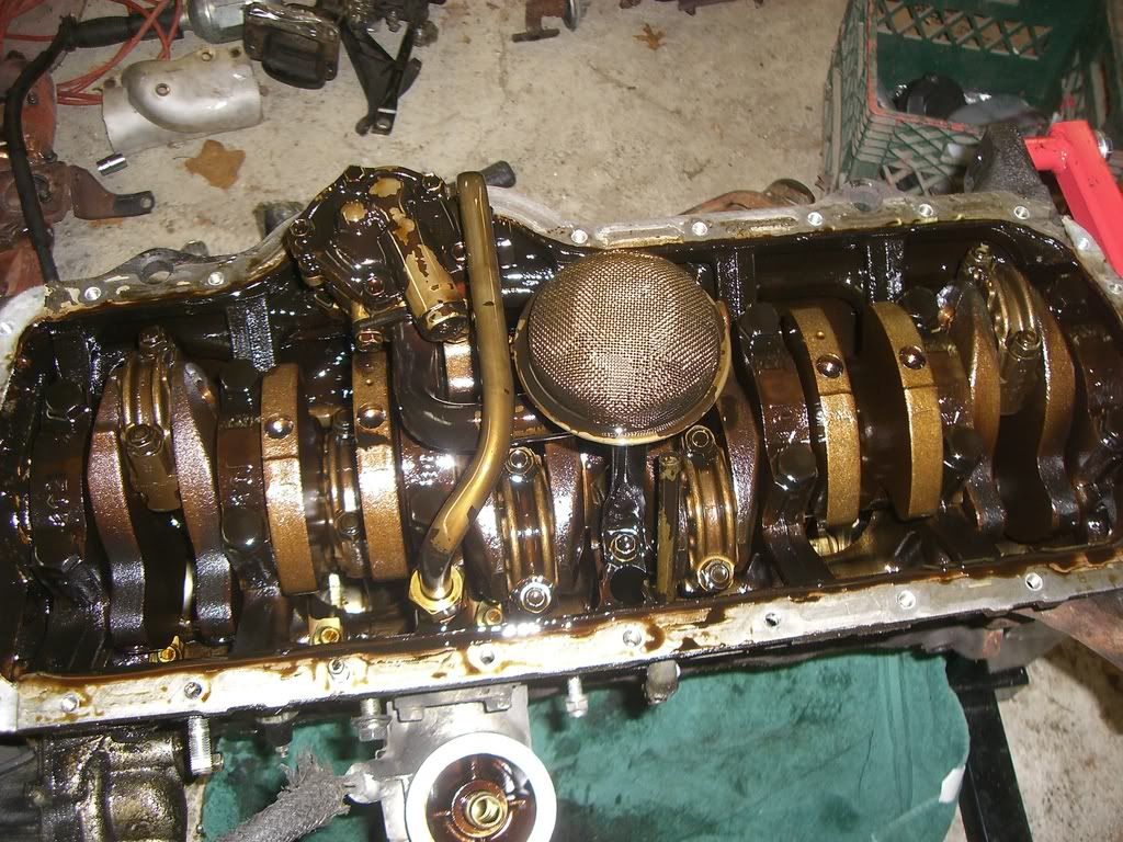

Well guys i was right about diagnosing my BHG. have a look at these pics, ever seen anything like it? It pulled the surfaces around the water jackets togather, on the exaust side and a few on the intake side....i have no idea how it kept running, or how it passed all of the compression tests i did to it?

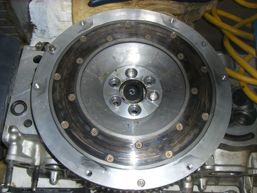

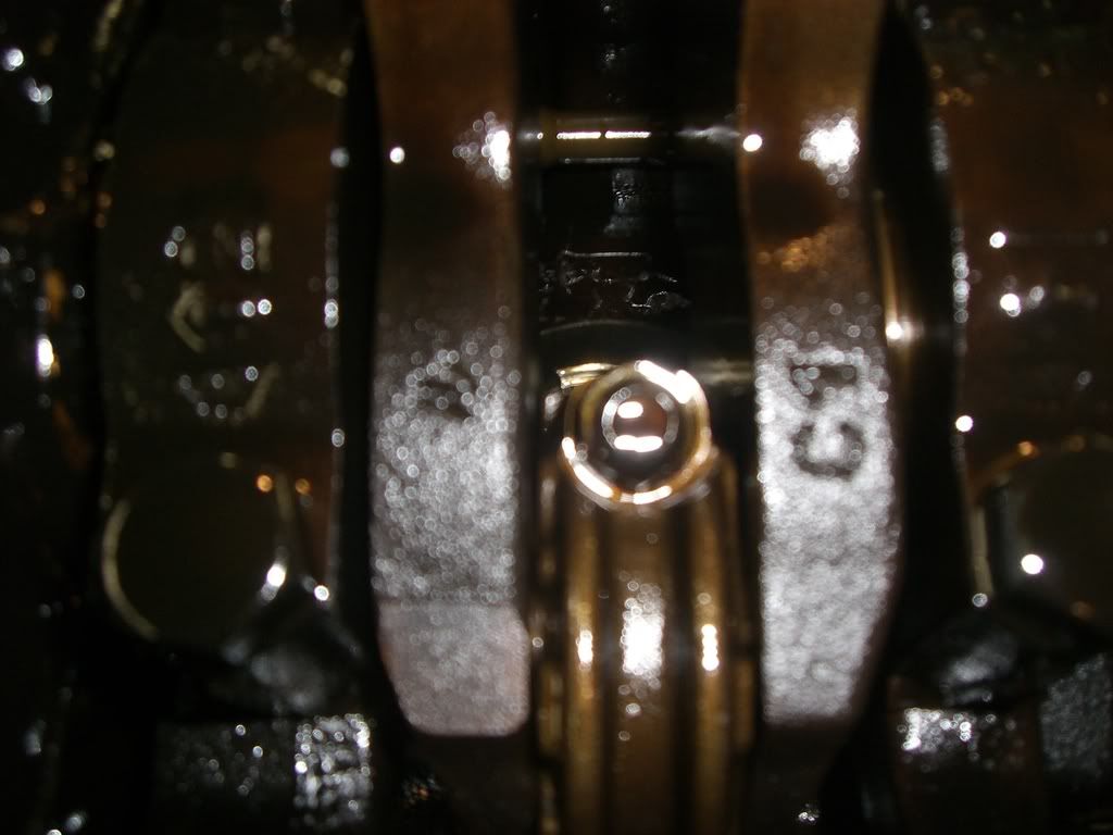

O and two more quetions. do i have a 7m Crank? i dont think this is the motor that origionally came in my car, i have an 87 targa turbo chassis? i have a 6m crank at the house and it dosent have the same markings, it looks to be a bit beefier than the 6m, and it dosent have 6m labeled on it anywhere. and the last question, does my flywheel look ok? its been installed for 5000 miles at the most, along with the Rps stage 2. i think it looks a little ruff, anyone with experience with the findanza chime in.

HommerSimpson;1077935 said:
put ya glasses on IJ its a 7m lol
YES, im glad, so this definetly ensures that this isnt my original motor. explains the wiring harness mess:3d_frown:.

So does anyone have any advice on the flywheel?

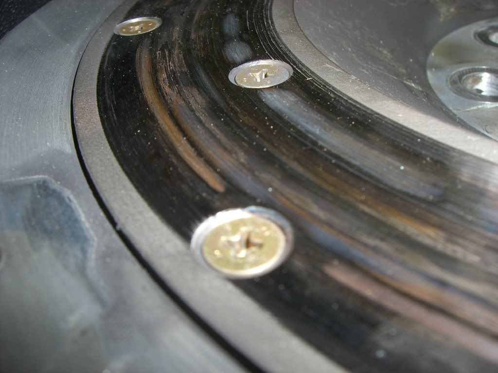

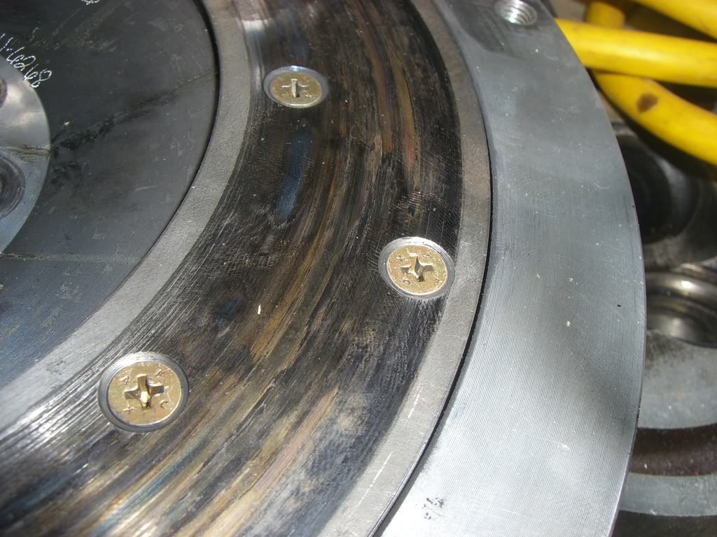

Guys, im asking if you think it looks bad, not if i can have it machined, and i know about the rubildable plate. The clutch and flywheel have only been in for about 5000 miles. Im asking... does it look normal for the setup, and the period of time it has been in? someone with experince with the findanza unit help me out(lets compare).

Looks to me like you have some serious high speed glazing on the flywheel. I would definitely recommend getting it fixed, either replaced or turned.
Probably wasn't properly broken in or wasn't perfectly clean when it got put in.

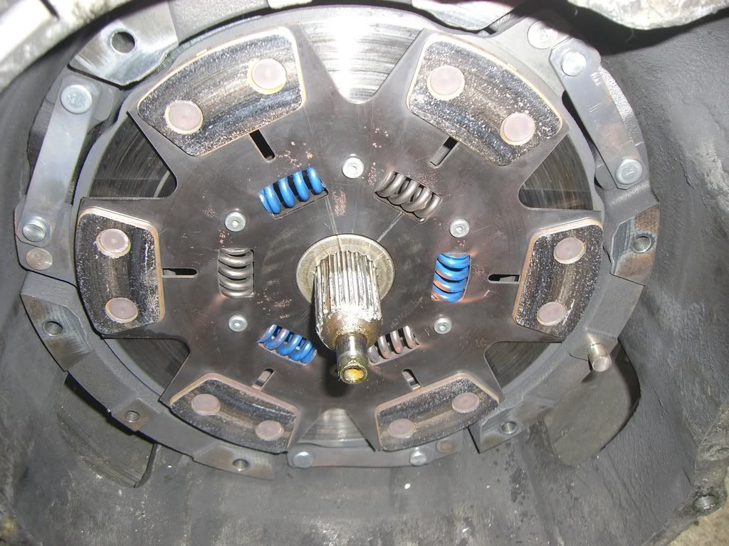

Sorry didnt know it was a fidanza cuz i havent seen the flywheel on my turbo motor yet so i dont know if it looks any different from the n/a model. ... but yeah i would probably do whatever is possible to get it back to a flat smooth surface again, and ive been told to take it pretty easy for the first 1000 to 2k miles for a proper break in. Also if this is a light weight flywheel and depending on what clutch your running i would do my homework to make sure the materials are correct for each other.
