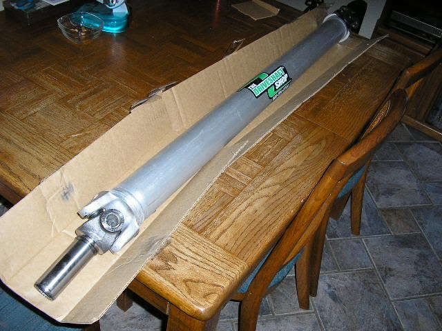

Arived today at around 1:30. Can I just say I love UPS?:biglaugh:
Looks like next week my car goes back in the air for some fun! Now I can drive my car again! Light as hell too only 14-15 lbs steel. That plus my new 3.9 rearend should be a great combo.

Yes it was much lighter than I expected it to be! I guess I should expect a little more power? Or atleast more of what I already had.:biglaugh:

Nope....
No amount of weight reduction in the rotating assemblies is going to give you more power.....
It might change the PMoI and the car will accelerate quicker and this effect might make it feel more powerful but it's not.

Congrats. Been running that same one for quite a while now. Make sure you use new lock washers, and a little locktite on the nuts and bolts. The flange is pretty tight on the head of the stock bolts, and makes it difficult to get a wrench or socket on. Oh yeah, and it rusts quick. Wish I would have cleared mine before I installed it. Just fyi.
