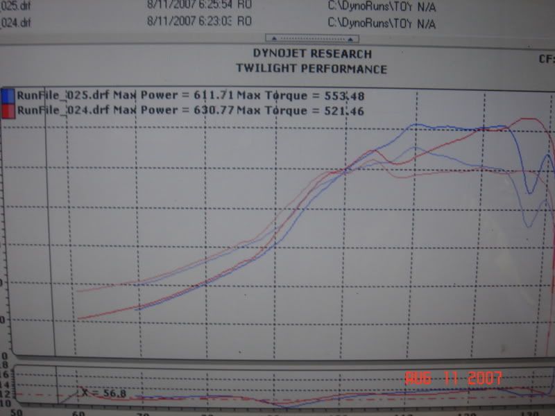

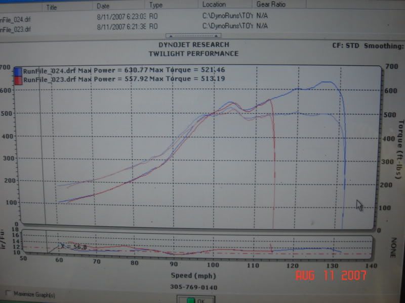

Here are my results from my mk3 2jz!
My injectors were @ 60% on this 630hp pull.
Mods:Garrett 66mm Turbo
Tail 44mm Waste Gate
Precision FMIC
Greddy Type R BOV
Aem Cam Gears
Greddy Pulleys
2x255lph Fuel Pumps
-6 Feed -6 Return Lines
850cc injectors
FPR Kit and Fuel Rail
Greddy Eman Ultimate
3inch Customer exhaust
My fuel set up was suppose to be -8 feed and -6 return but ran the wrong line for feed so I said I will keep it that way.
Ran 24-29psi
