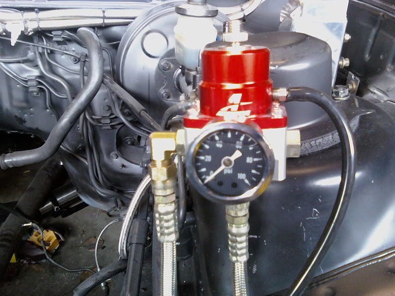

currently i have a aeromotive FPR and guage "LIPP FPR kit"
http://www.suprasport.com/Aeromotive-AFPR-_p_77.html
now as for fuel rail, currently i have the AN fittings from the LIPP Kit which contained the fuel Rail Fitting 12mm to -6an AFPR -6 inlet fitting AFPR -6 plug for unused port AFPR -6/-6 adaptor for return Braided hose, wes from http://www.beechperformance.com/ said this is what i should do, but i contacted jack larson from www.suprasport.com also, wes says this "The hanger comes with a -8 fitting but we can put a -10 if thats what you want. THe stock rail will work but it needs to be modified to get rid of the stock fitting and have an fittings welded on which we can do." he also said this "what i would do is cut the plug off the back of the rail and weld on a -8 fitting and plug the stock feed and run a -8 from the pump to the rail and a -6 return thats how my car was done before but now im running tripple pumps and a -10 feed." jack larson replied about what i should do about my rail by saying this "We do offer the LIPP fuel rail with 6,8,10 feeds single or dual. You may be able to modify stock but if you weld a bung on it will most likely warp the rail making it junk. lmk, Jack"

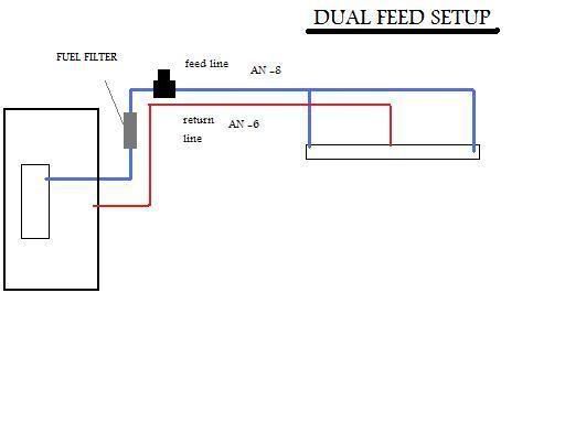

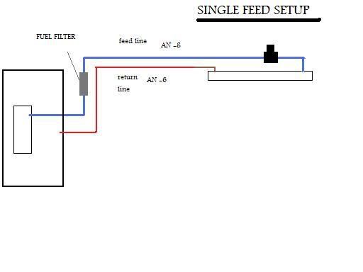

now a little more information on this is im going to be running 1000cc injectors with this set up, here are some drawings in paint with what i feel how it would be set up.
now for the dual feed would i just have the feed -8 going from the tank to FPR "bottom port" which then requires a -8 adapter for the bottom port instead of the -6 on there now, then use one of the side -6 port and then use the unused port for the other feed, and just use -6 fuel feeds, would that work?

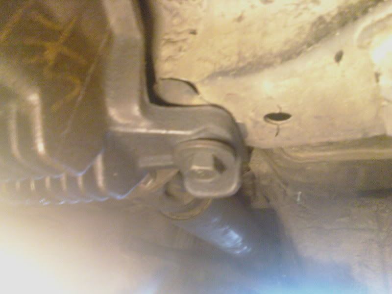

and this is a different story, while i was taking off my fuel tank i noticed somthing terrible :cry:
my rear end frame has a split right where the bolt is, what do you guys recommend for a fix, i figured since its close enough it could probably be welded right back up, or should i just weld a fresh piece of metal right on top of it? because i really dont want to have to buy a new one or find one :nono:
