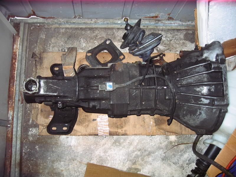

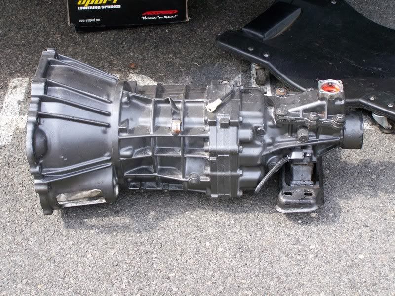

This is what the R154 looks like. It's a lot beefier than the W58.

If you bend over and lift the tranny with your back instead of knees, and nothing pops in your spine, you have a W58.
