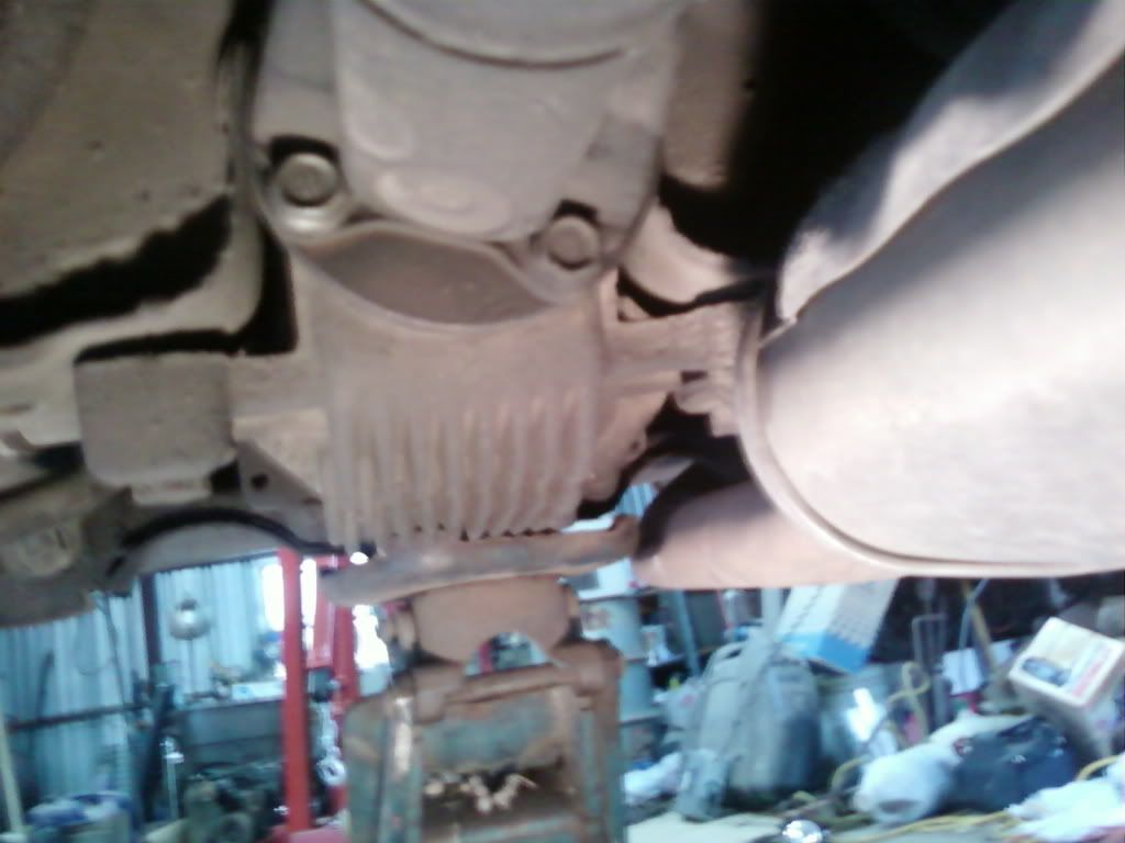

Ok. So today I finally had the chance to get up under my car. The first pic is looking straight up at the u-joint just behind the center bearing. Sorry, but it's a cellphone pic with me under the car and very little clearance. I did have the car in neutral and rotated the shaft so that that knuckle in the pic would be straight up and down.
Here is a pic looking down at the last u-joint. Notice how it's offset some. Does this mean my shaft is out of phase? If so could this have caused my first center bearing to fail? After replacing it, the center bearing, last week I noticed the vibration was worse.
64
If it's out of phase Yes and Yes, it will be more noticable either on power ore backoff, most times it's harsh on overrun when you lift off the throttle and let it engine brake.
So would you say from looking at those pics, it's out of phase?
My acceleration feels very "course" and when decelerating like on the freeway it feels like I'm driving over very fine bumps, more of a loud buzzing feel.
64
ie: "Harsh" ;)
Need a pic along the shaft to be 100% sure but it's easily visible to the eye when they're out of phase so you tell us :)
The Uni's should be perfectly in line!

IJ.;1408253 said:
ie: "Harsh" ;)
o---------------o
Well I couldn't get a pic of the whole back half of the shaft from under the car, but I'm going to assume that it is because with the front straight up and down, the back is cocked off to one side. So the search for a remedy begins before I destroy this newer bearing. Money will be the issue, especially while going through a divorce.
64
You have a couple of options, find a straight shaft and install it along with a balance or have the bonded section replaced with a straight tube making it a true 2 piece (this is what I've done in the past)
