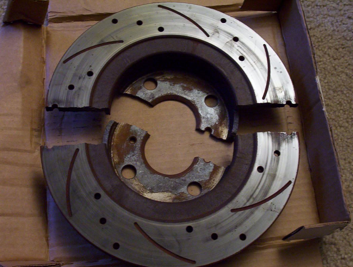

my personal expierience with drill/slotted rotors is I've had an ebay set on my car for 3 years now with metal masters brake pads that I got off ebay and with a titan brake line kit and I've never had a problem with these brakes. autocrossing canyon crawling 140+ mph to 0 braking drag racing and so on. oh and did I forget to mention 2 years of pizza delivery on them as well? anyways I've never expierienced brake fade cracking of rotors vibration warping of rotors or anything with them. and as for slotted reducing the brake pad life by quite a bit I call bull honkey on that. I'm still on the pads I installed on my car when I put the rotors on my car 3 years ago and have half the life still left on the pads. yes I believe they reduce the life of pads a tad but not significantly enough to worry about it. anyways. I hope other will post PERSONAL expieriene with pads and rotors not more of "well my friend had this friend that had this problem" kind of crap that we see alot of. I'll take the word of someone who personally uses a product of 50 people saying they heard it was bad without any expierience with the product.
born2drv
Nov 1, 2005
1,199
Burbank, CA
damn, cracked exactly in the middle of the drill holes on both sides... doesn't get more definitive then that :) does he beat the shit out of his car or something?
