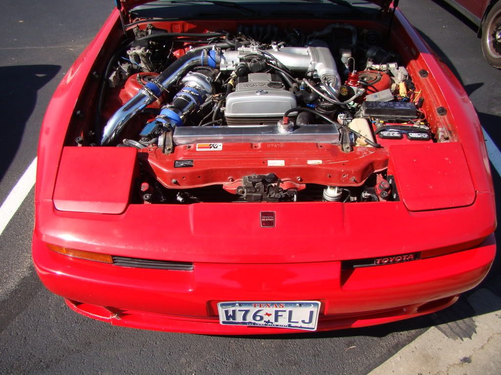

Woot, passed emissions on the first try! It was close but I scathed by on the rough tune. One of the tech's took some pics of my engine bay too which was pretty cool. Also got a free carwash/vac/interior clean, figured I'd take a couple pics since this is the cleanest it's ever been and probably ever will be:
Doesn't look dented from pics... but they are low rez...
Straighten your license plate and adjust your driver's side windshield wiper :D

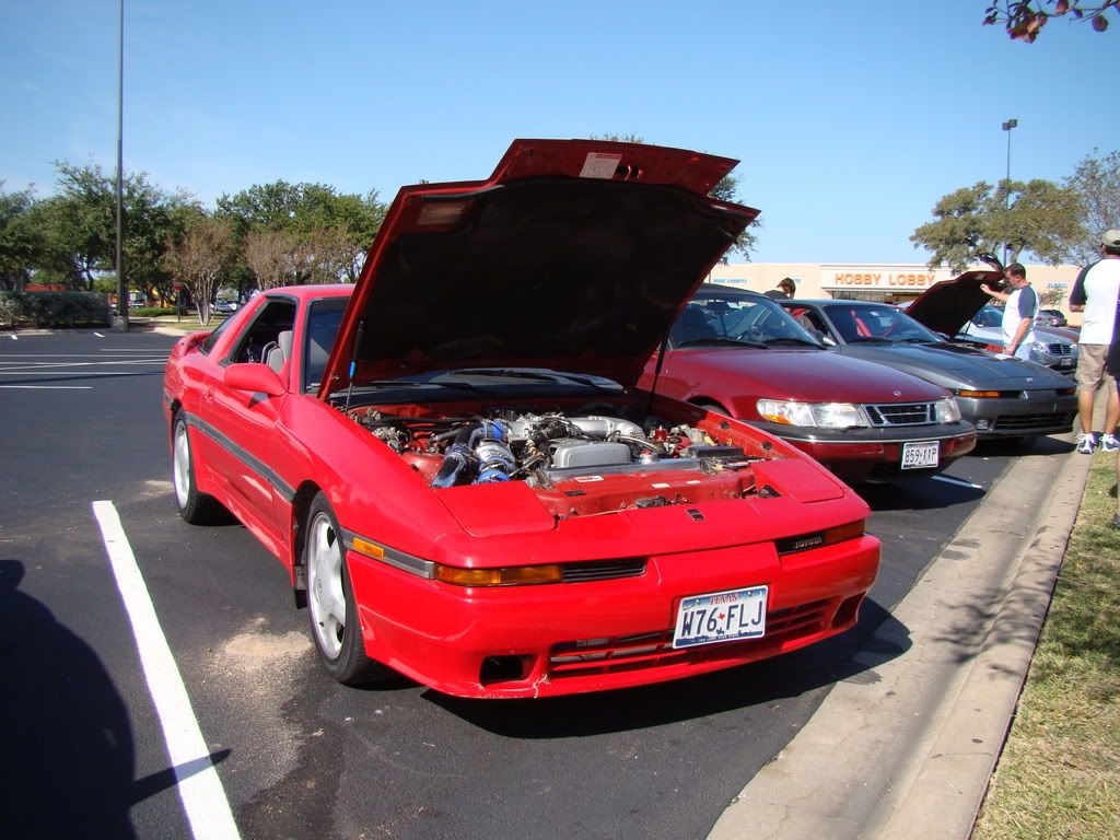

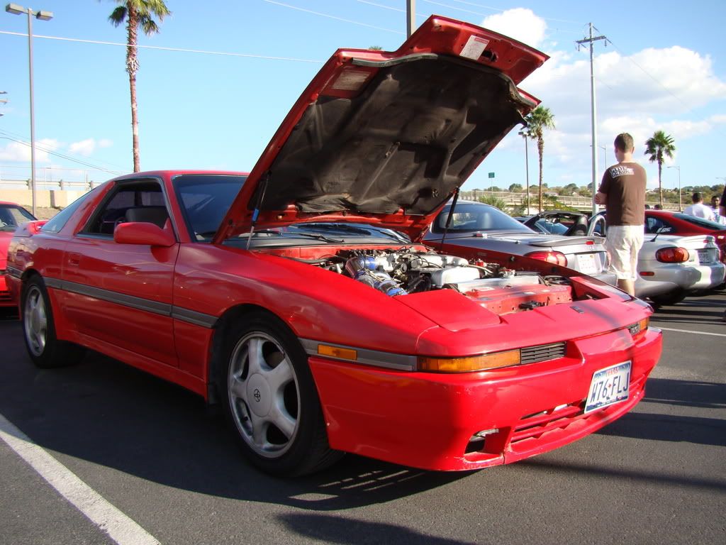

Some pics from the Cruise this weekend, luckily somebody took some of my car because I didn't, spent enough time under the hood to have everything memorized:nono:
