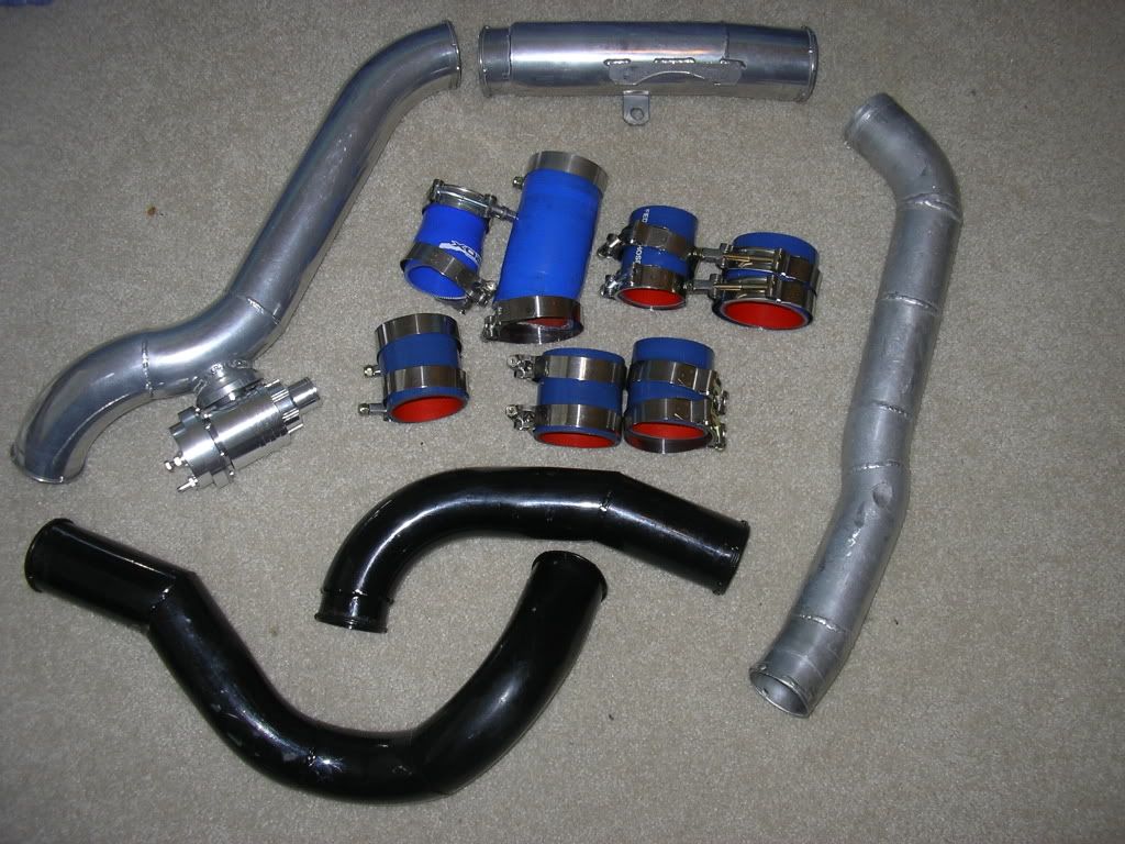

IC piping is a b!tch!! I couldn't get things situated with the hotside running up top but I think I did figure out a path that would work but it's going to require flipping the thermostat housing and using a different lower rad hose... Taking a break before I throw something:3d_frown:
5
you need another bend in the hose
Turn the top coupler so the hardpipe goes straight down, then angle it back towards the front. It can't be riding on the sway bar!

Got the coils mounted on the firewall tonight and yanked some wires out of my old 7M harness to finish out the wiring (TPS, ISCV extension, alt harness). Figured I'd share some pics...
Starting to look like an actual engine bay:
Charge pipe routing:
Tight clearance near the turbo, should be ok though:
