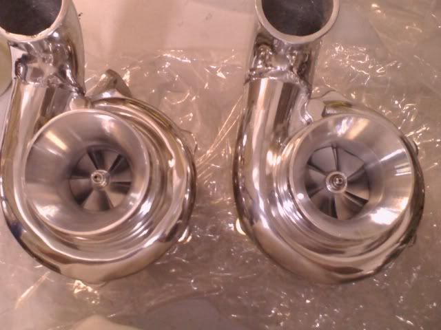

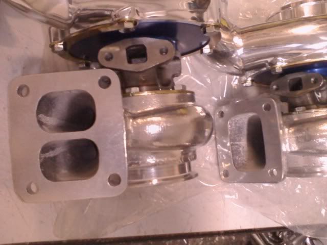

Here's some pics taken today, a 57 trim with .58 AR devided housing on the left, and the DM67 with .81 AR undevided housing on the right. The 57 trim is going to be for people who want faaaast spool with the capability to make around 450whp. The DM67 is for a 2JZ kit I am putting together for a customer with a 600+ whp goal. I don't think any pics I have taken do the compressor housing polish justice, they do a really nice job on it.
