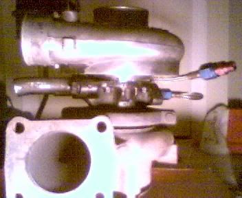

different oil lines?
walka
Oct 16, 2005
46
beltsville, MD

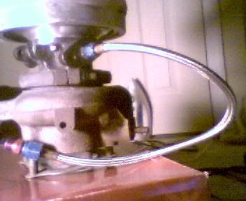

i got this turbo from someone here on the board and i realized the oil lines are different...there is no coolant lines i think
im not quite sure how this hooks up? anyone seen this b4?
63
Yep if you shut it down right away after a hard pull it will boil the oil the Oil that in there then turn it to carbon and this is the "Coke" I'm talking about.
It's a bad thing as it's very hard and will trash the turbo and is the reason turbo timers were invented (not to mention think of the poor shaft spinning at 100.000+ rpm and you shutting off it's supply of oil suddenly).
In a water cooled housing it's not quite as critical as they'll thermosiphon and circulate the coolant even without the motor running and this is enough to keep the temp low enough to prevent much sadness.

ooooo lol
the way you told me you said air cooled..i thought you were trying to say that air cools the turbo..and the bearings will coke up ...i thought you were makin a joke lol i didnt know you meant yea its oil cooled...yea i just bought a turbo timer for that reason..thx
