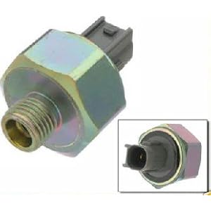

Early style, roud plug:
Later style, D-shaped plug:
I don't know about using one of each kind, but I bought a pair of '94(iirc) 4Runner knock sensors, and spliced in the new plugs.
Haven't had an issue in 5+ yrs.
PS- This is on an '88 harness/ ecu.
toml
Jul 24, 2005
203
Adelaide, Australia
<img>
<img>
Thanks, that's helpful.
Where did you get the new D-shape connectors to splice in?
