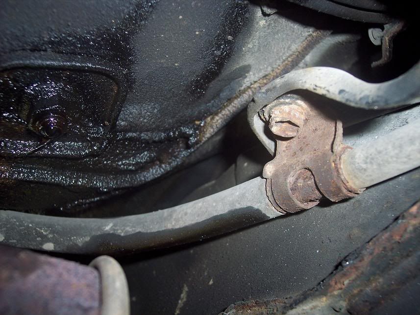

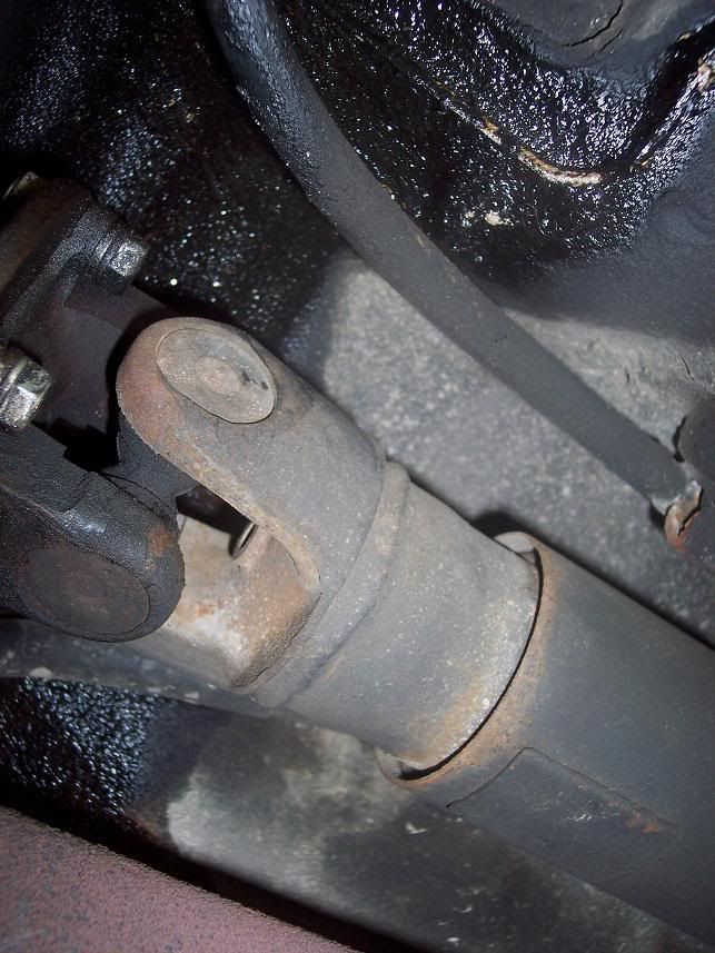

As the title says today i got under my car to check some bushings out on my rear suspension and i spotted what looked to be gear oil all over the buttom of the car above the diff snout. The top of the diff itself was dry, The subframe above it was dry, It wasnt dripping the whole diff was dry as a bone just the top of the car had what looked to be gear oil on it and part of the exhaust where it looked like it dripped down and burned onto it.
The weird thing is it doesnt smell like gear oil it all......it has no smell.
Two days ago i found 2 drops of gear oil in my driveway and they smelled of it strongly and looked exactly like this substance on the buttom of my car but they were up the driveway about 3 feet in front of the diff i checked the trans and it was dry also.
Heres a couple of pics of the oily mess but it was hard to get very good pics you can see it over the driveshaft and on the ebrake cables.
We thought the seal may be leaking only when hot and slinging it up there but i just drove the car yesterday if it was slinging it wouldnt there be atleast a little bit dripping or still on the diff or subframe?

she is weeping replace or live with it teh seal on the pion gear shaft is leaking
you will have to re perload you pion to the ring gear to fix this
i recomend not useing the factory crush sleav since it is pie oh shit
