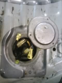

Ok first pop your hatch and unscrew the plate covering the fuel sender unit assuming that you don't have the wood or the carpet in there still.
unplug the 2 connectors becarfull they are old.

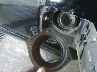

Take off the right rear wheel; use the 8mm socket to take out the screws that hold the plastic cover that cover the filler neck, should pop right out. Once again be careful this is old plastic.

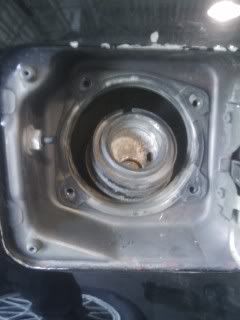

Inside the gas door take out the 4 Philips head screws that hold the plastic thing around the filler neck, you may have to use the flat head to pry this off. Be careful and act slow, its really eazy to chip your paint or scratch your car.

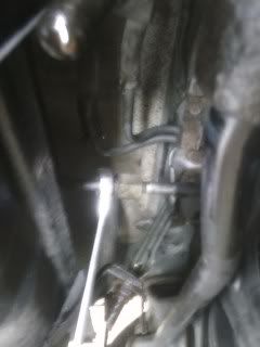

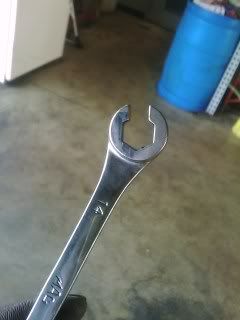

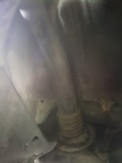

Grab the 14mm line wrench and the 19 and take off the metal fuel line. Remember the 19 will be doing all the turning and the 14 is there just to hold the line from snapping off. This is a big step with out this your not dropping the tank.
This is what a line wrench looks like.
this is were it goes.
lefty loosy righty tighty so think about it and then act. Fuel May come out so watch your eyes and mouth and cig if your smoking at this point.

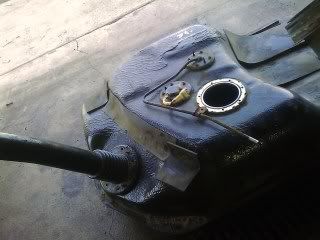

Take the 8mm socket and take out the bolts that hold in the fuel pump {its the one that the larger opening with metal lines.

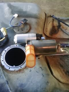

Once the pump is out it should look like this. that's the new pump next to it.

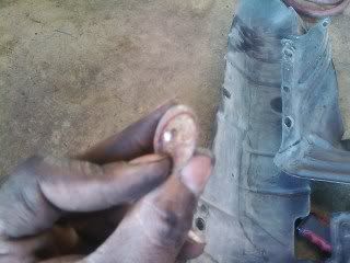

The adepter connector is above the new pump I wont show my ase skills but make sure you note what is positive and what is ground ok.

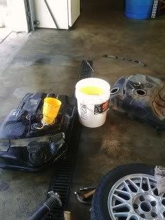

All right now all ya gotta do is put it all back together just the way it was. YES EVERY NUT AND BOLT back on. unless your like me and I had a 3/4 full tank so i was not gonna waist gas and have to refuel my new tank with gas. :nervous:
so i had to find a way to transfer it. I had alota dirt in my tank and I'm sure that's the cause of some problems.
