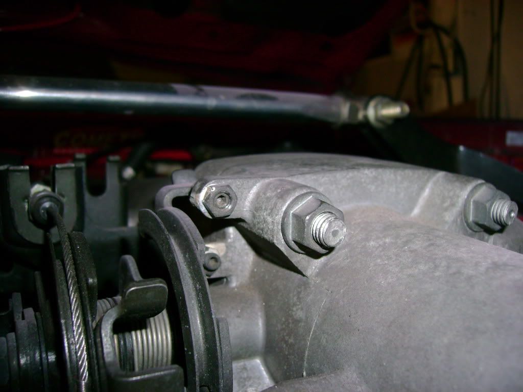

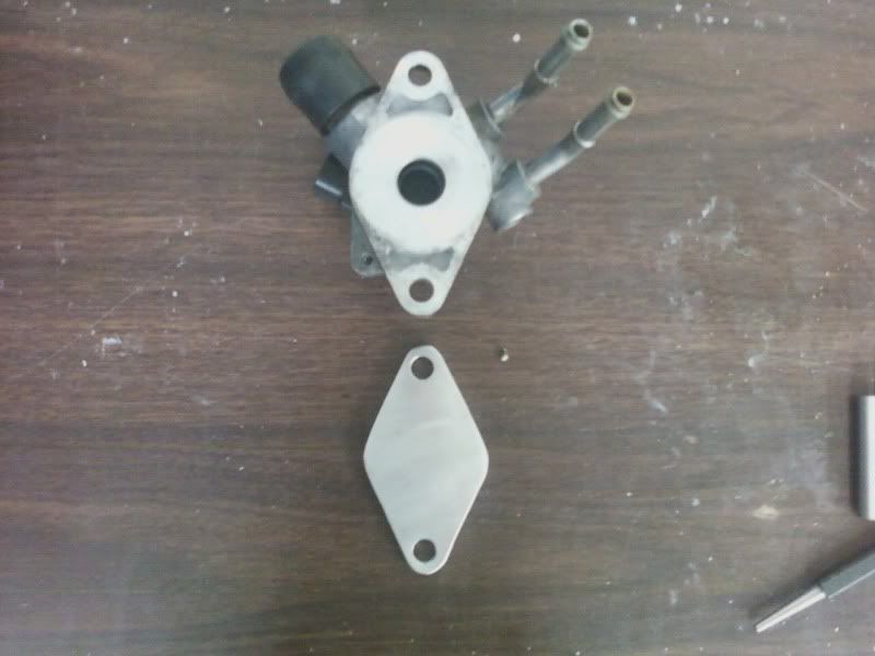

This is what I did to mine and my buddys. Both single. And both idle fine.
I really don't see the big problem....

Mine is basically blocked off like that, the tube from the motor and the one from the ISCV are both corked and the unit itself isn't even connected. What did you do with the coolant lines?
Albert
May 13, 2009
1,710
Tempe, AZ
I personally welded them up shut. Putting screw in the hose seemed to work for the time being, but seems the easy way out
