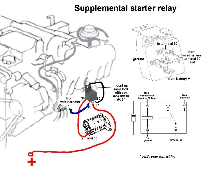

This has been an intermittend problem since I started this thread. The battery did not fix it.
I need a new wiring harness.
I have patched the problem with the 'UK relay mod' and it has cranked every time since.

Was going to suggest that, mine had the same problem, click from relay but to start, play with it then it would crank. Mine had something to do with the factory alarm not giving a ground source.
Put in a Bosch relay and hasn't done it once since then.

All this does is pilot the starter solenoid in exactly the same as the car's stock circuit. To make matters worse it's not even bypassing the stock circuit where the single point of high resistance lies. It's still being used, just that now it doesn't have to deliver the same current as before. In other words this mod doesn't jumper around the bad spot, it only lowers the current enough to temporarily overcome it. That's what makes it such a hack.
You should've tracked down the root cause using voltage drop testing. It can only be one of a few components and I can assure you it's not in the harness itself unless it's a bad connector. While this mod is a quick way to overcome doing diagnosis it didn't treat the disease, only the symptom. The disease is still involved every time you turn the key. At some point the symptom will reoccur as the resistance reaches a level where it'll be unable to supply enough current to energize the pilot relay. That could take several years or happen tomorrow. As I said, that's what makes this mod a hack.

I haven't given up on finding the root cause. That's why I didn't say I fixed it, only that I patched it.
The starter has cranked strong ever since and, before the relay, it became a daily occurrence. That and having had the starter tested seems to assure me it's not the starter. The problem is somewhere on the control circuit, as you have said before JJ. The voltage drop testing should locate it.
