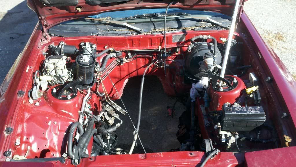

Purple power ftmfw!!
before
after
before
after
Holy...SHIT! Okay, you gotta help me out haha, what EXACTLY did you use, how long did you let it sit. Did you use a brush to aide in getting it that clean, or you just rinsed off with water? Wow that came out very, very good.
Anything you can comment about the cleaning of that would be very appreciated :)
