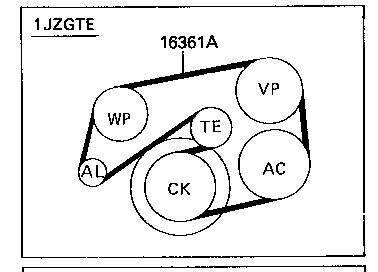

after deleting the ac and power steering,do you have the waterpump spinning in the right direction?

The water pump will not pump properly unless you have the belt on tight I think thats most likely your issue I deleted the AC then went with a belt that landed the tensioner in the middle mark you almost want it at max at new so when it settels out and streches a little there is no slack in it.
