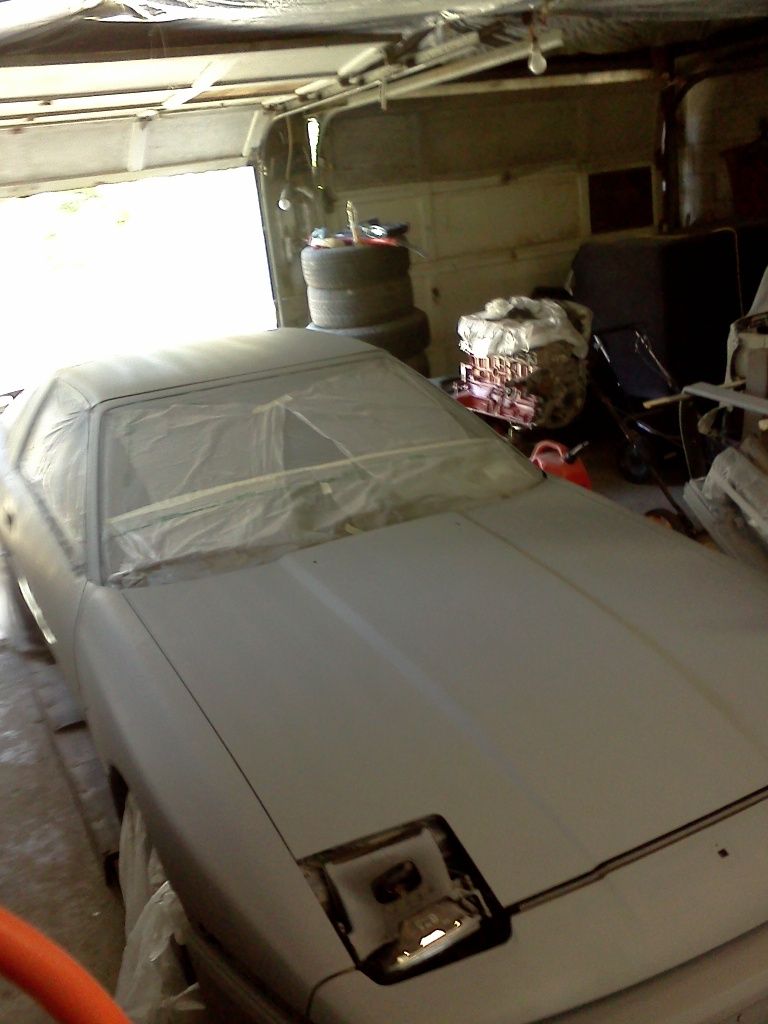

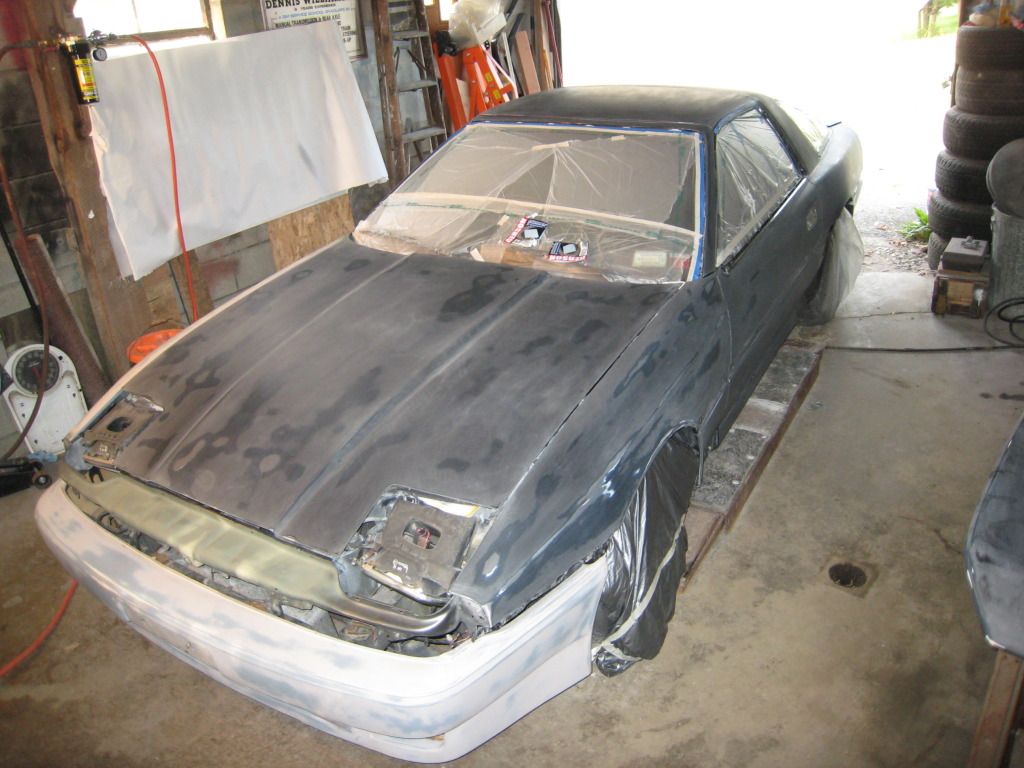

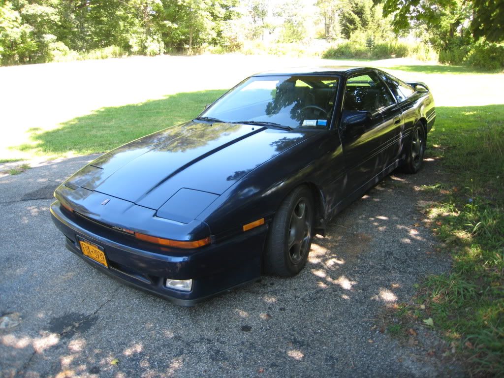

Sanded
Primed

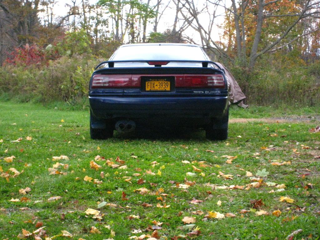

Painted (had the stock exh on temporarily, I need to get a new pic with my kickass Tanabe exhaust)

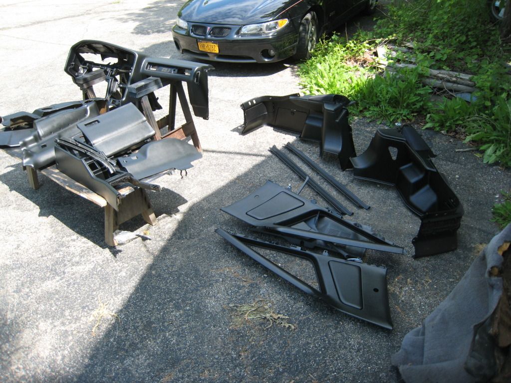

Interior stripped
Interior painted

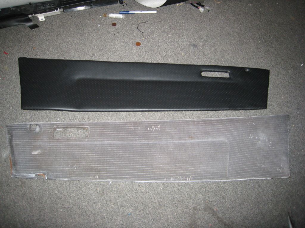

Re-covered the panels

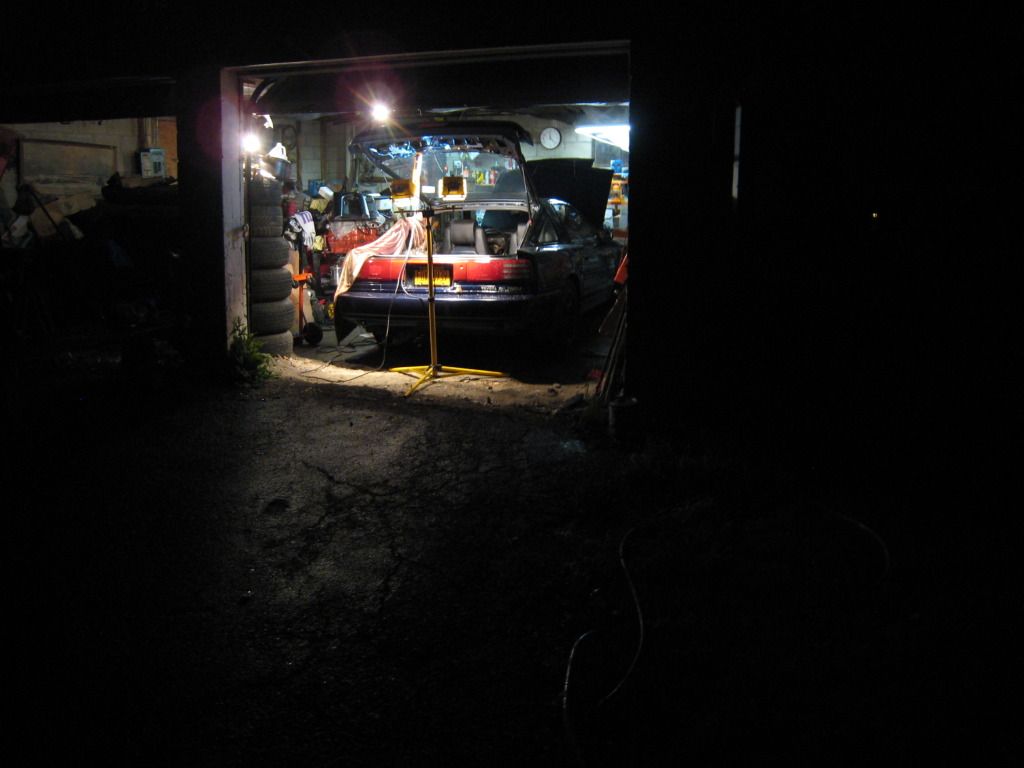

Typical 2am on a Thursday for me:

Vroom! Tanabe Touring Hyper Medallion!
