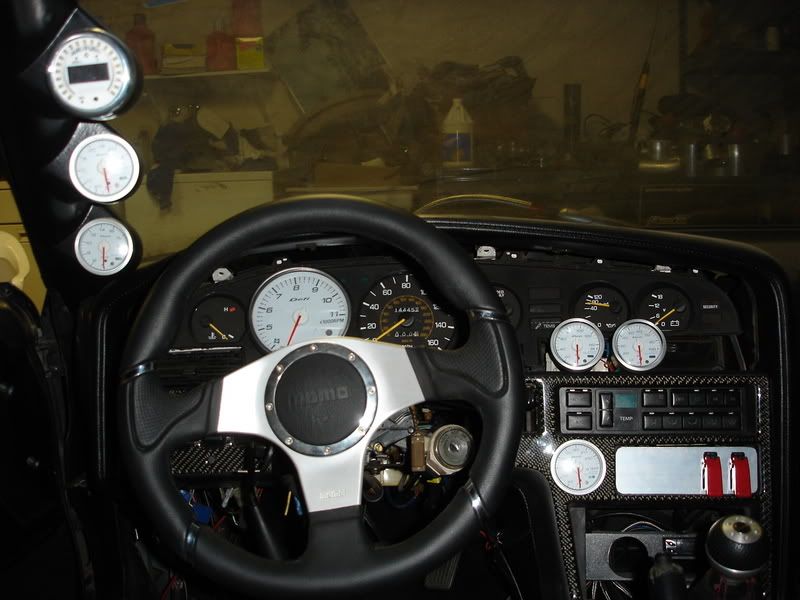

can you post pics where you put your gauge? I just bought a Defi and when it gets here I'm not sure where I want to put it...

Seriously, no, i'm really embarrassed, they look like shit. I put a bunch in at once, and I don't like A-Pillars so they're just all stuck to the steering column, and the part above the factory gauge cluster, upside down(the gauge cup, not the gauge)
When I was just running a boost gauge I used the included gauge cup and put it on the steering column, off to the left, it fit great so I could still see all the tach.

See, that's the thing. I had A-pillar gauges before as well and I don't want to do that again.
I asked specifically 'cause you I saw you had defis and I know they can only be so far apart. I want the boost gauge on the steering column, but I'm not sure if I'll have enough slack to get the others somewhere in the center DIN area

what I did, because I'm impatient, not cheap is made my own harness. They make them but I didn't want to wait for shipping.
Its true, the gauge-to-gauge harnesss that come with the gauges are only about 6-8 inches long.
I cut one in half and used some.... 18 guage or so, wire and extended it.
I have my oil press. gauge in front of the factory one, and the water temp gauge in front of the stock one... so they're kinda far apart. My cable I made works just fine :)

once i get the rest of the in-cluster guages as i call them, in order from left to right keeping the stock speedo/tach, i'll be custom installing them into the stock gauge cluster. it will go as follows, using Defi gauges: water temp, oil pressure, oil temp, boost.
the rest will be installed where the climate control unit was. (relocated to passenger side of dash, it's not like i keep adjusting it anyway, and it's not hard to reach.)
though, i might mount my LC-1/ xd16 gauge up near the cluster as well.
