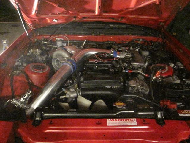

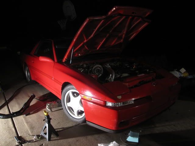

Sorry for such a late update, haven't been able to work on her for a long time. I'm hoping to finally finish up everything tomorrow. Stayed up til 1 finishing up the exhaust, here's a late night pic
Things to do...
Meth kit,
Wire LC-1
Bolt up the exhaust
Fix leaky PS coolers
Flush the coolant ....
I'm sure there's more.... Will get more pics up tomorrow

Update, well I found out that I was leaking fuel from the fuel hanger lines. When removing the feed line to the fuel filter I must had bent up the fuel line enough to create a pin hole leak, it didn't help either that the lines were so rusted up. So the plan is to make custom lines from the hanger to the fuel filter. I just have to find a m14 x 1.5 hose barb to go to the inlet of the fuel filter.
Also having issues with map ecu2, I'm having problems with my laptop connecting to the unit itself. Sometimes its working, sometimes its not... I recheck all of the wiring 3x...
It'll be awhile for another update because I don't plan on working on it for another 3-4 weeks :(

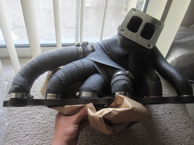

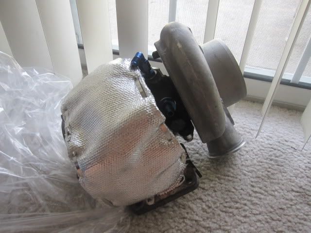

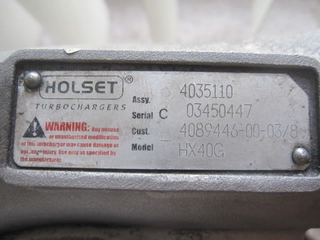

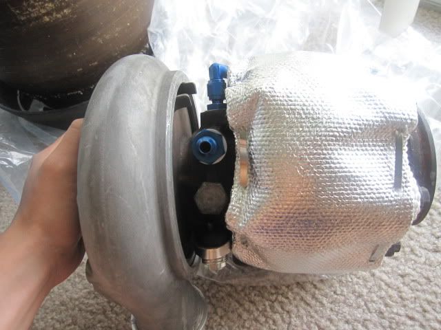

cyberdx16;1559186 said:
Got the turbo off of homemadeturbo.com and found mapecu off ebay. Here's a few pics of what I've been doing, havent had anytime to go back home and work on it so took a few parts back to work on.
oil and water cooled!
Almost done wrapping the header, just need to weld the egt bung
next time you wrap your manaifold get the wrap really wet and wrapp it on tight then dry it wiht heat gun and ti will be come like steel and never come off
