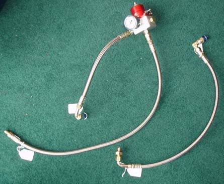

In the photo below there are 3 braided lines i have the same AFPR (uninstalled)but i do not have the 3rd line that is not attached to the AFPR in photo. I believe it connects to the back of the fuel rail and gets rid of the Pulsation Damper.
My question is this 100% must do ? or can i skip this line and leave the stock one in?
Im sure i cant cut corners so if not Can someone point me to a place to get a replacement line ?
Im sure any braided fuel line work?
Another question is about the J-Tube Mod/Just eliminating it.. So basically installing the AFPR it self is eliminating the J-tube as the fuel lines no longer go to it at all after the AFPR is installed? Or am i missing something here. (Just wondering if it is really that simple)
Sorry if the questions seem stupid or like i overlooked the answer.. i Just would rather be sure then sorry later.
To the best of my knowledge, the 3rd one is not needed for what would appear to be your overall HP plans (the lexus AFM/550 upgrade) I have done the same fuel system mod, looks like the same setup I bought from DM, but like you said, only the AFPR and the two lines, not the 3rd. I have also coupled that with two other upgrades, one is the fuel pump, I personally went to the Denso Mark IV pump and also did a fuel pump relay/ resistor mod, not exactly the same as commonly noted on this site, but works well for my setup. I have left my fuel pump dampener in place, I think it serves a good purpose as long as it does not get in the way (perhaps higher HP applications).
Yes it is that simple, you also get rid of the banjo bolt stock setup on the rail...

It dampens the osilations from the fuel pump. Kinda like a shock and spring(pump is the spring).
If your going to do this mod you and run higher boost you need a bigger pump. Which also with that the jtueb should be drilled/by passed anyways.
If your going to be a higher hp level getting rid of the dampner isnt that bad of a idea and all high hp cars do not have 1.
Just get lex, 550, afpr, wide band, pump. Install all. Set fuel pressure to about 35 psi. Up the boost and watch your afr's. A safc/ maft would be really usefull at this stage as well.

hvyman;1682663 said:
It dampens the oscillations from the injectors opening and closing. Kinda like a shock and spring(pump is the spring).
FTFY If you're familiar with the way the ACIS system works, it's the exact same concept, but it's dampening it instead of enhancing it. Stops rich and lean conditions based on the oscillations.
Not true.
