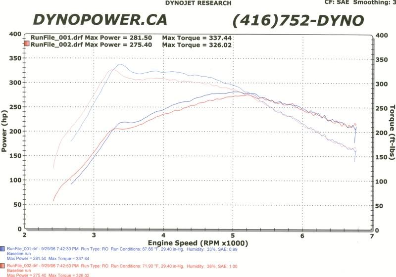

FIGGIE: This is my stock turbo 7M at about 12 psi. It falls to under 10 by redline. Probably similar curve to Lil Miss'
