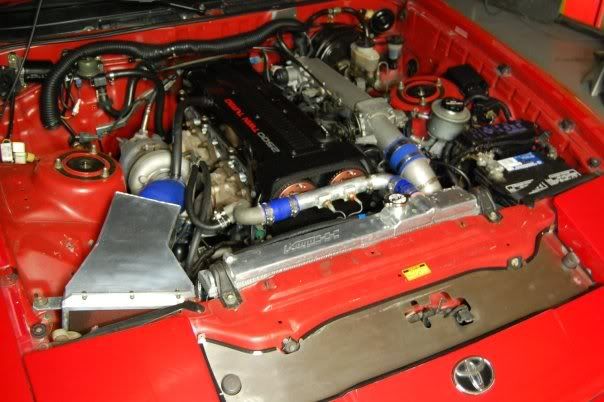

wtf is going on here?? I have a 57Trim from DM and the manifold as well. Tuned by sarkis at dynoextreme made 331WHP on 12-13PSI right before cut. The CT2657 will max out around 370-380whp on pump gas and stock internals. I ran purple top 550s, 255 walbro pump, afc neo. You can pump more power out with a standalone ECU with timing and ignition control, but 500 is gtfo.
Brand new rebuilt CT2657 with ceramic coated exhaust housing\polished intake housing.
Edit: btw the CT2657 kit has treated me quite well, the lag is not that noticeable and VERY similar to the stock twins. With cams and a standalone ECU this setup could possible break the 400WHP mark.
