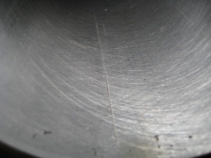

Another question i have is the block i am getting machined has a scratch in the number 1 cylinder. I can just catch my fingernail on it. My plan is to have them all bored out .020", my only concern is i dont know if that will be enough to remove the scratch. I need to buy the pistons before i get the machine work done, so how do i know which pistons to buy? I am using a machine shop that is about 5 hours away from here, so its not very possible to have him determine this and then have me buy the pistons and keep going back and forth. I have a picture of the scratch, maybe you could give me your opinions.
This was after a light honing with a ball hone. My bet is .020" over could get rid of that, but i don't want to take any risks. Also, does NPR make piston oversizes anything over .020"? I was hoping to use NPR pistons, but if .020" doesn't do it, what other piston options am i left with besides Toyota OEM (I want to stay with stock style pistons). THanks
