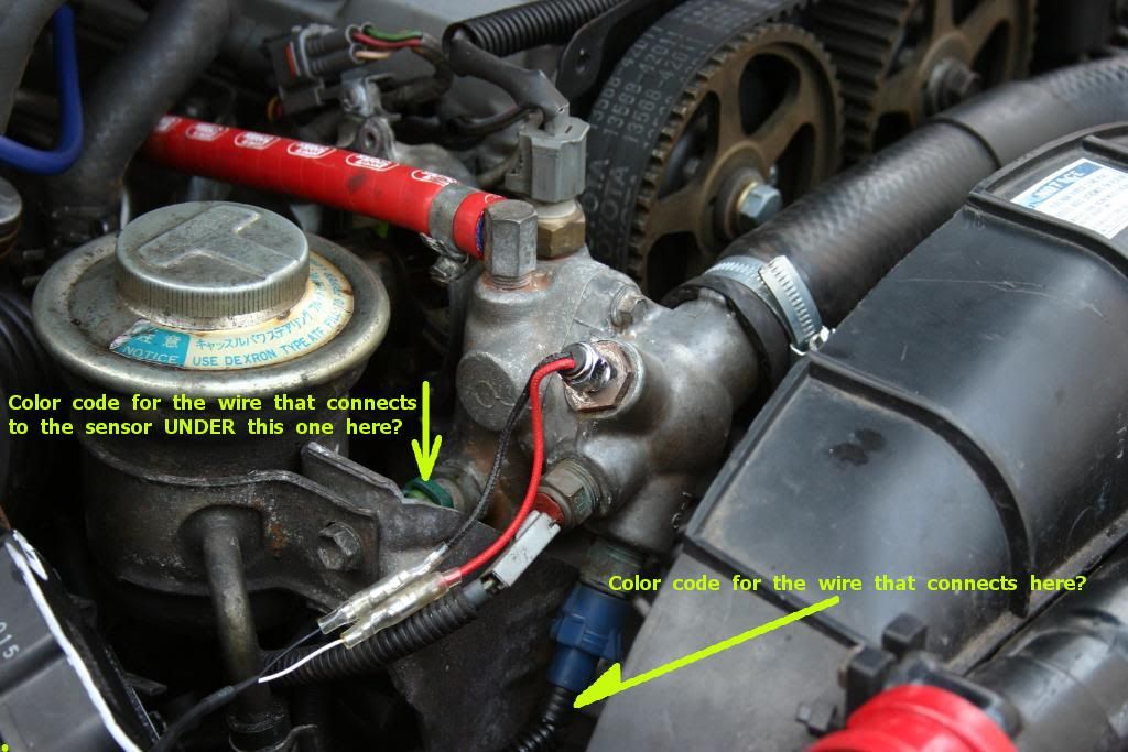

Finally got the power plant back in after 2 years....1st ignition was a no go...ECU was lost because the Sensor was not connected to the ECU..Broken wire...yadda yadda.. Below is a Picture of a 7mge Thermostat housing, but I have a 7MGTE where I have question on the position of 2 broken wires we have.. one of the wires is Blue -yellow stripe, and the other wire is Mint green with a red stripe coming from the main harness across the Camshafts..I have 2 sensors where there are no wires connected and I don't remember where they go since the ends have broken off. This photo is NOT my car, but I have arrowed where if someone can tell me the correct wire colors:
Thanks in Advance

And there is one on top for the csi time switch which you will need.
Lg-r is for the a/c temp sensor.

Thanks for the Info bro!! Wow! Just what we needed!! Video coming soon..

what problems will come from not having the radiator cooling fan switch hooked up?
+1 The wire going to that connector broke. It has been ran for a short period of time this way, though nothing seems off. Could it cause potential damage?

It's there so say you live where it gets 100+ outside and your sitting in traffic and the car is getting a little hot the fans will kick on for extra airflow through the radiator.
Think they kick on past 200' so your already a bit hot when they kick on too.
Helped my car not over heat when the heater vsv hose cracked off and lost a lot of coolant.
With the 1jz it's gone tho.
Also it always kicked on if I used ac since the condensor has a lot of heat going through it it heats up the rad a bit more.
Good to have but not nesseccary.
