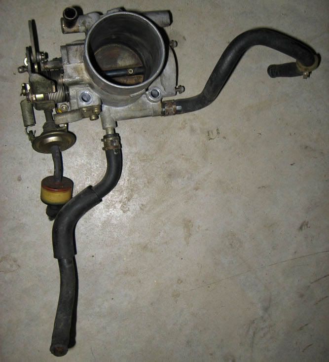

Is this any good ?, I just completed a BHG repair over the weekend, guess what; the only problem I had when I started her up was this bloody pipe leaking. The only way I could get at it was to remove the throttle body and upper inlet manifold. I used some Loctite silicon sealant and a new clip, seems ok now fingers crossed. I don’t think the pipe spigot (or pipe union as Toyota call them) is a replacement part; it doesn’t show up as a part in the EPC. However if it does unscrew you should be able to find a similar fitting from an airline/pneumatic catalogue. I got the picture from Google, do a search for Throttle Body Supra MKIII search by clicking images you may find some more info. What happened to our summer?
