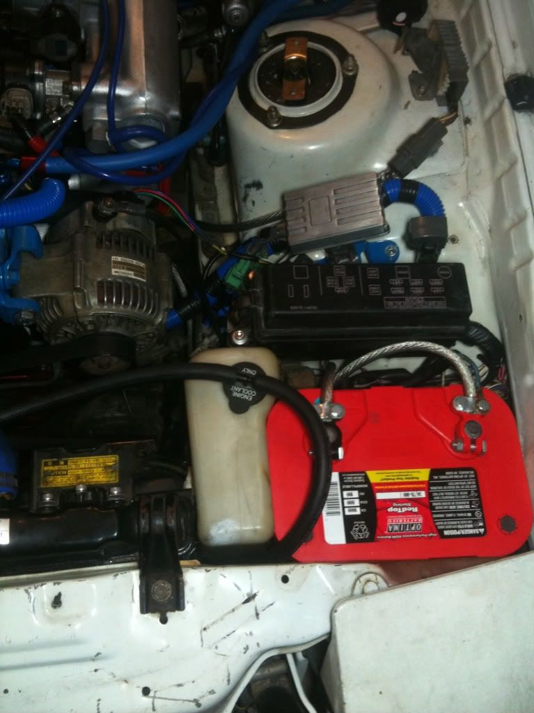

Kckazdude
Mar 16, 2007
1,239
Memphis, TN
Adjuster has the cleanest factory relocation I have seen. Dont have any details of it other than this picture posted in his F/S ad.
