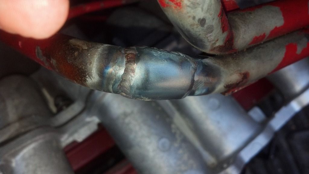

jetjock;1947965 said:
.... If you want to worry about something worry about the little cap on the pax side of the engine.
I did!
supraguy@aol
Well-Known Member
Dec 30, 2005
4,282
72
Atlanta
LOL- very fair question, after looking at the pic.
No, I took this picture, while holding the entire pipe assembly over the engine, that was on a stand.
It's not a plug; rather, I cut the nipple off, and had a shop tig weld a slightly larger section of pipe over it.
TIG welding is beyond my skillset.
