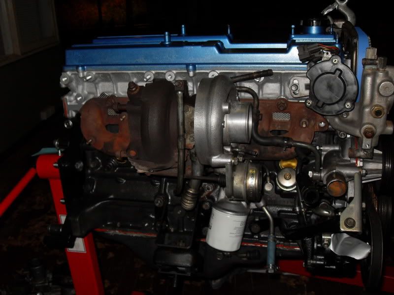

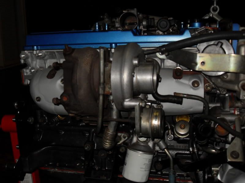

its not that bad, you need to remove accordion hose, p/s tank and the bracket that holds it on, from there you MAY need to turn the spring clips. you will probbly need to bend the alloy plate back as'well to get to it.
here's a few pictures i have that may give you a better idea
