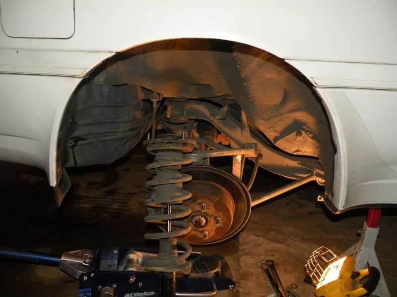

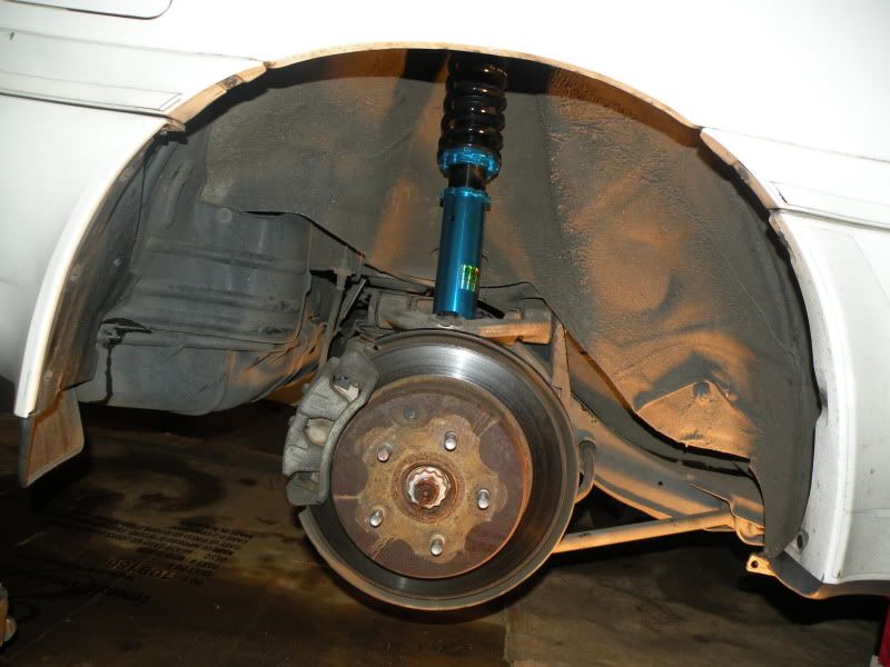

So far, I've only installed my rears, but it was super easy!
Of course...having no rear subframe in the car provides a not-so-surprising increase in working space...

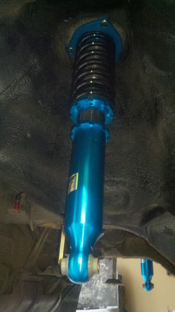

ive got them on finally. took me 3 hours!! got stuck on the very last one.....go figure huh. but rears were the easiest. going to put wheels on tommorow. cant wait to see how it looks, then test drive and adjust! :)

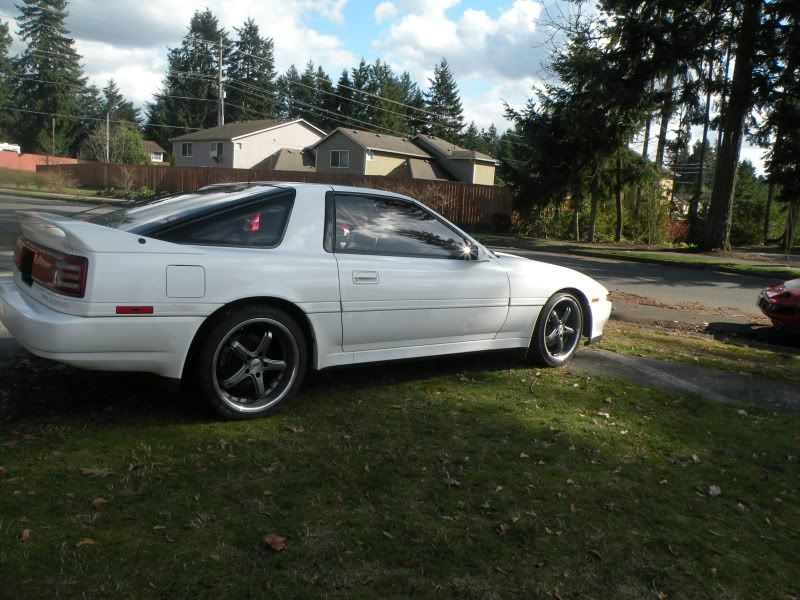

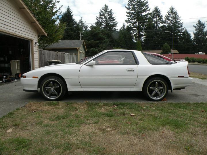

the last pic was the car b4 i put coils on it. the pic b4 shows how it sits currently. sorry but not going to redo the coils as i paid to get my alignment done yesterday. 90$ for that. bc each time u mess with your coils, u have to get one done,otherwise itll be off wack.
