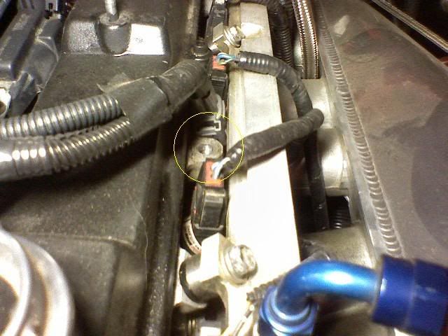

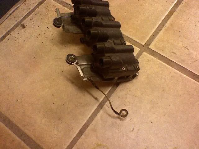

I installed the coil packs today and I could swear there was a small ground wire that came off the intake side of it when I took it off. I could not find a good pic in the TSRM, and searching here has confirmed that there is indeed supposed to be a ground. Despite labeling everything that came off the car, I cannot find this ground wire.

Where on the coil pack do I attach the ground? Is one of the bolts that secures the bracket to the valve covers acceptable?
Where is the best place to ground it? The bolt hole in the head (IIRC this is where the small wire was attached)? Or should I run it to the intake manifold grounding point where the other stuff is grounded? Suggestions?
