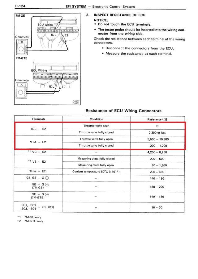

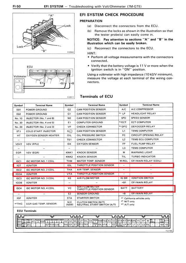

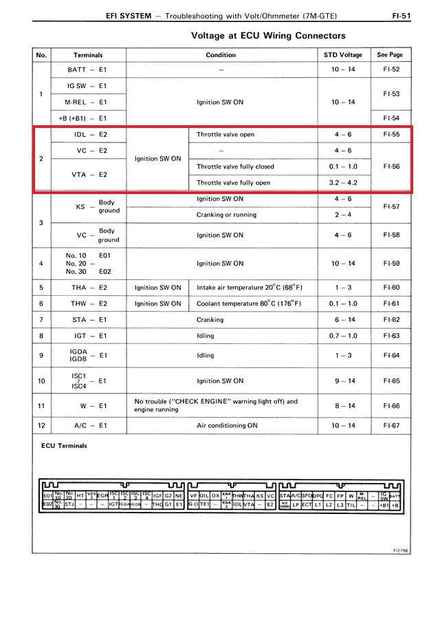

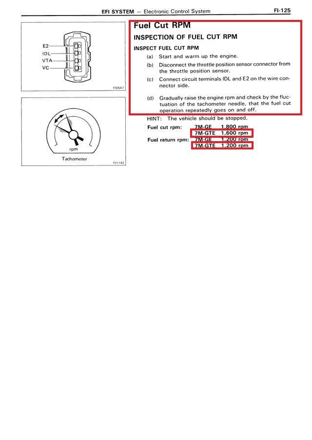

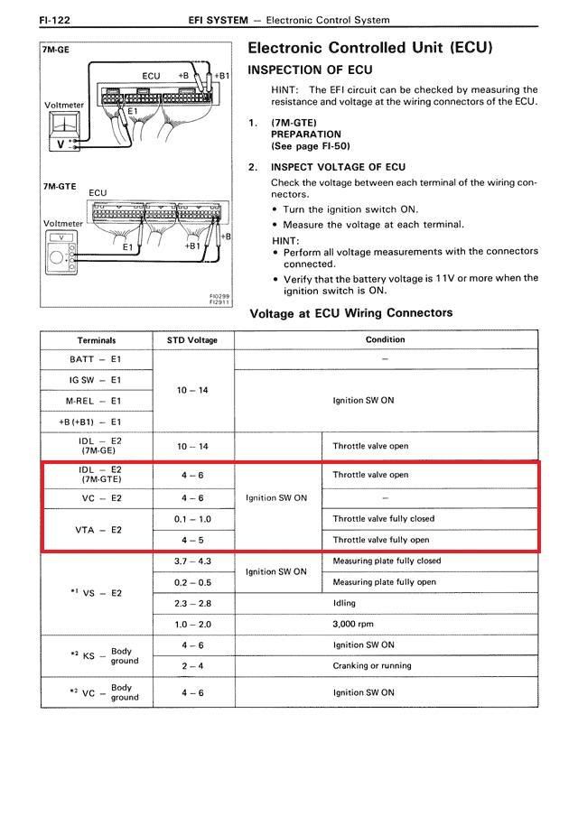

I bought a brand new tps and i tuned it correctly and it's all within specs but it's throwing code 41... Which is TPS... Why is this? How do i fix it?
Nomad707;1179419 said:trace the wiring.
i am very sure is not the battery, mine is new and i have the same problem, Help us please:biglaugh:chris89;1179506 said:I have another question. Would a bad battery cause this to happen?
