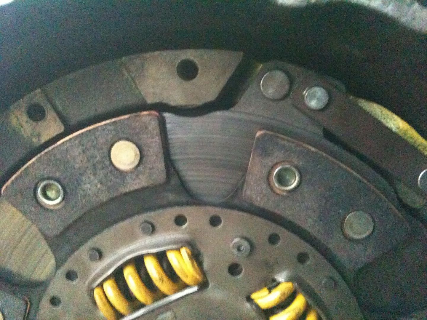

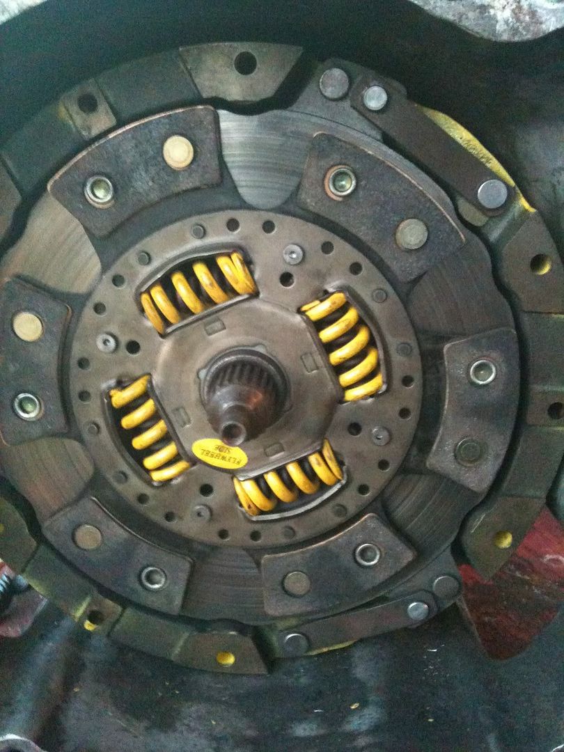

Second is that when the clutch is sitting on the PP, it hits the edges of the pressure plate, and stops from spinning. Here's a few pics of what I mean:
Are the 6 pucks supposed to be like that? Different lengths? They alternate like that btw, IE: short, long, short, long, etc.

If you trying to spin the clutch like how it is in the pic that is not how it is when bolted up. Notice how the bottom of the pp is sitting on the bell housing. If you hold it up a little bit it should not touch.
You can move the pp with the trans off farther than it actually goes when bolted up.
