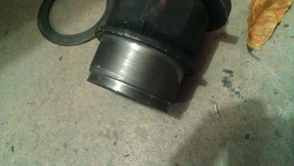

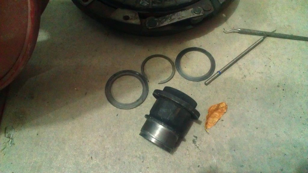

Dropped the transmission yesterday. Definitely found the problem. The clutch release hub was worn enough for the snap ring holding it together to fall off. Ordered a new hub kit and release bearing and we should be up and running in a week or so!

Don't worry, I will. Haha it was a bit of s surprise when I pulled the transmission out and the pressure plate fell off when I pulled the trans out from under the car lol

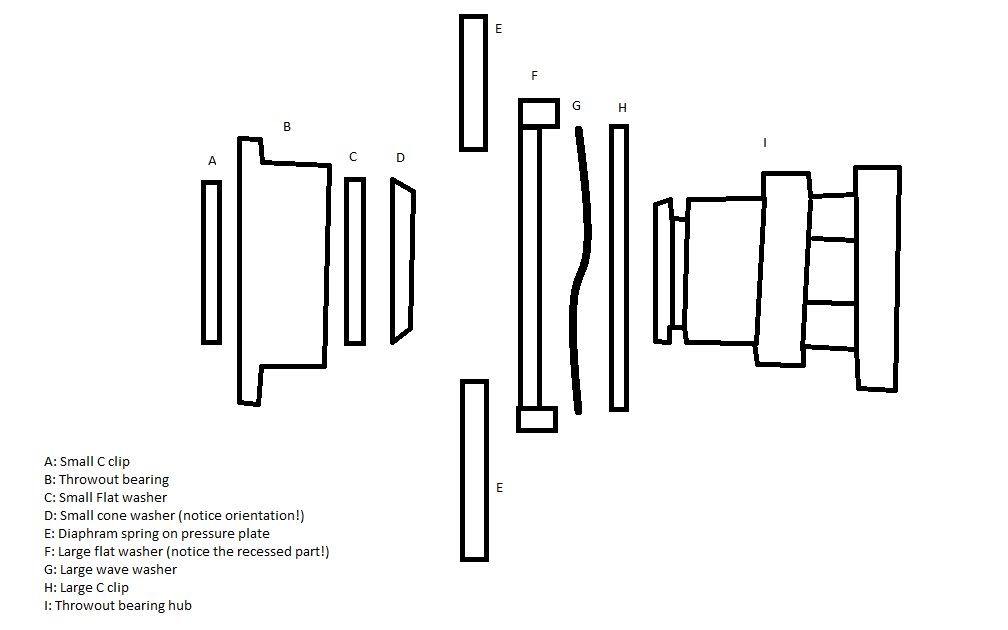

Improper assembly :)
I had a hunch it was that, but you didn't say if you heard grinding when you tried to push the pedal down or anything, so didn't want to smash your dreams it was something simple :)
Definately replace all the parts with new ones, it's cheap insurance (who likes dropping transmissions?)
This should help:

Its too light to be anything bit plastic. Oh well. That washer was missing before, and I'm thinking that's why it all fell apart.
