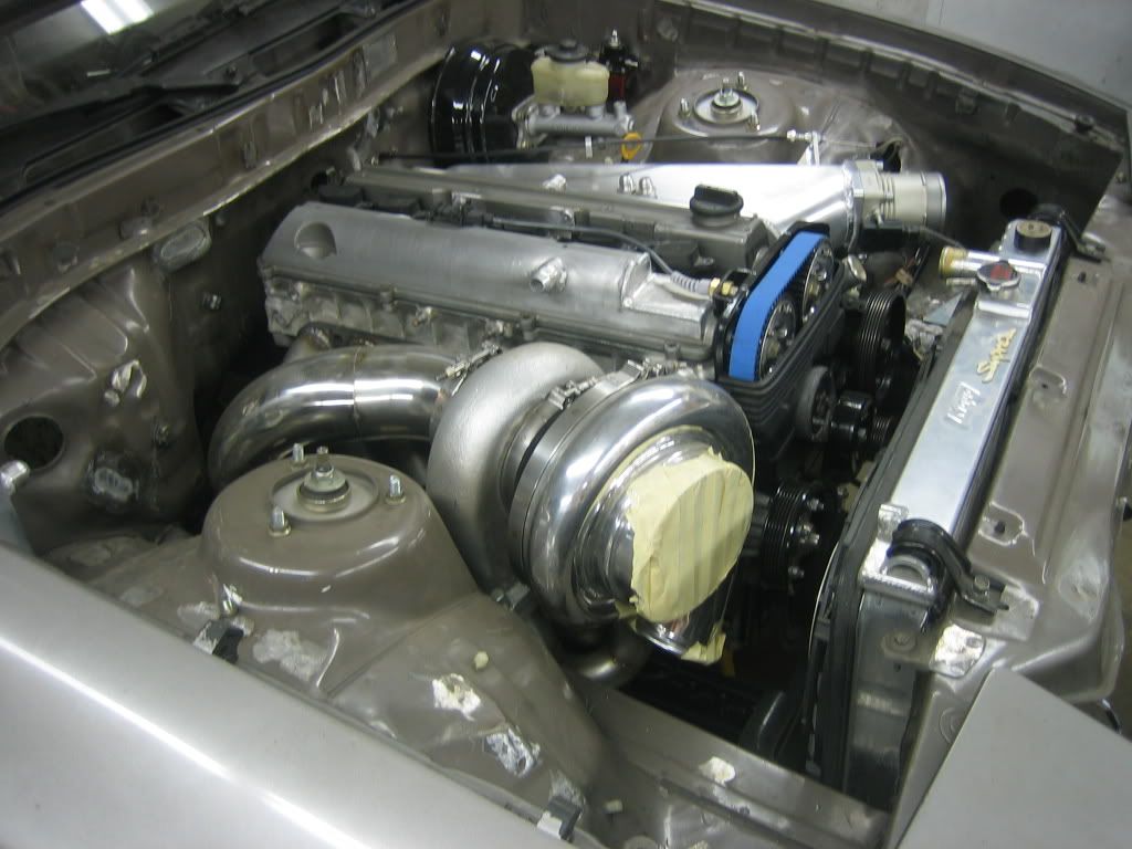

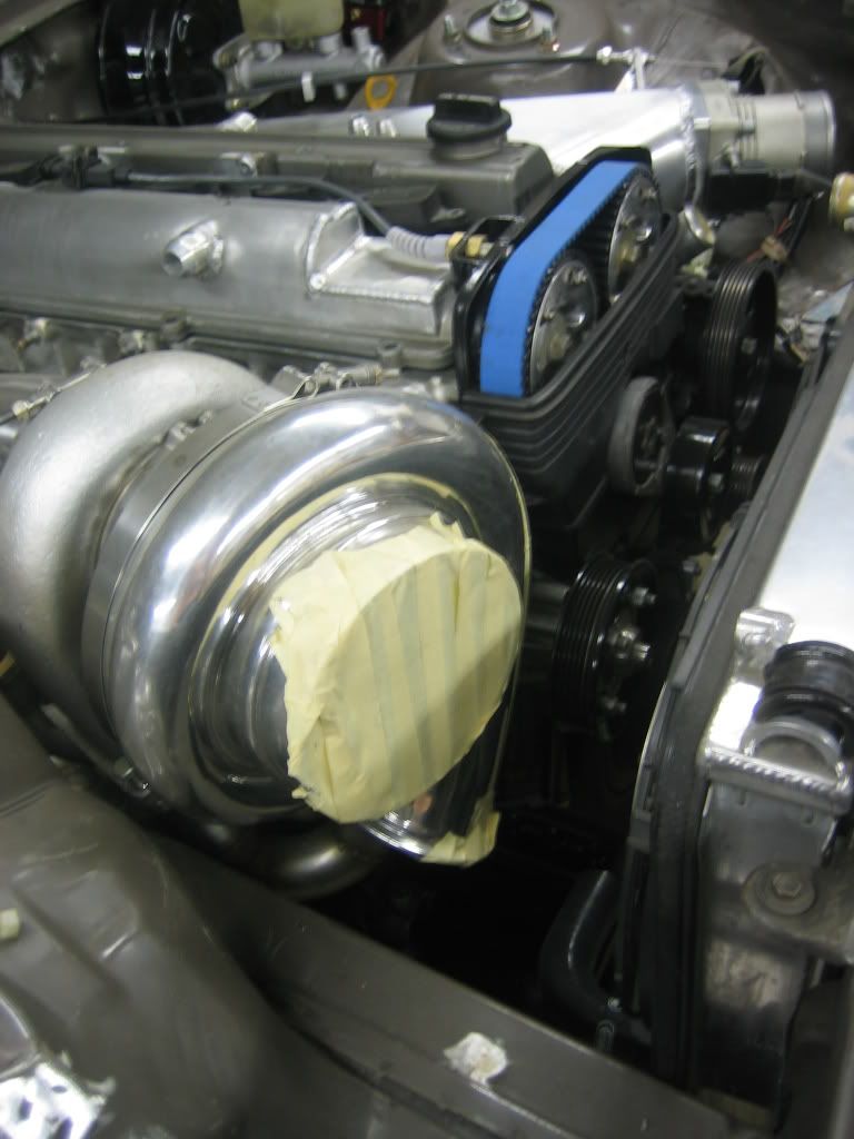

There is no possible way for my to bring the intercooler piping up under the headlight. The compressor housing will not clock far enough, and if it could, where the header sits it would point into the fender well. It HAS to go down below, so if anyone has pics of running the piping down below that would help out a ton.

If i clock the turbo so that it points upwards like that, there is literally 1/8" gap between the vband flange and the fender well. I would have to cut the compressor housing back almost 3". That and i really dont want to cut up the comp housing, as now the turbo is usless if i ever try and sell it.
Ive seen guys running the piping under like i need to, im pretty sure Duane and Ron both run theirs the same way i need to run mine, but i just cant seem to find any pictures. Ron had some on his build up thread awhile back, but i looked and the image host he is using is down or he deleted the pics.
