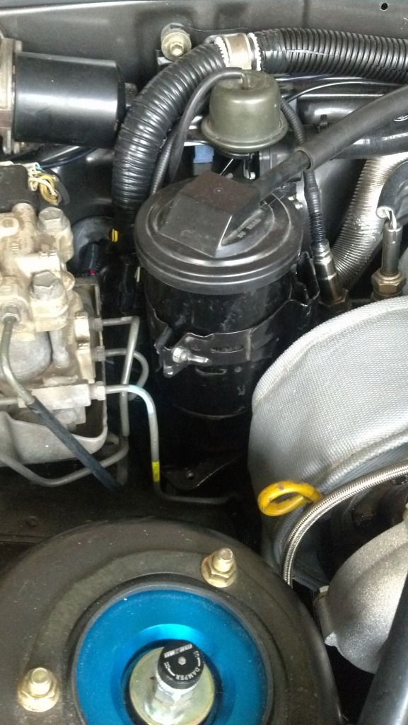

Hey all, I put line locks on the front wheels and dont have room under the hood for the charcoal canister anymore. Is there possibly a smaller option that I could swap it out for or would a more modern rear mounted evap box work from like a cavalier maybe?

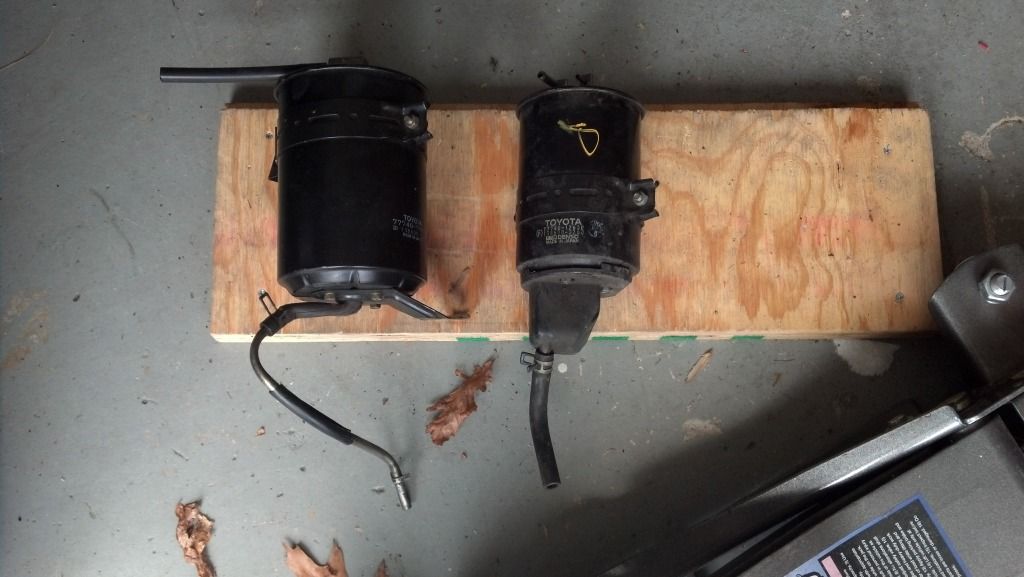

But the jza70 is smaller and fits in the fender well.

I used a Celica charcoal canister.
It's about 1-2" less in diameter, and mounts to the same bottom plate as stock.
