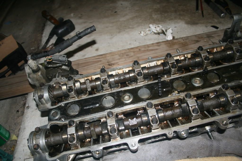

Here is a pic of the cams back on the head
