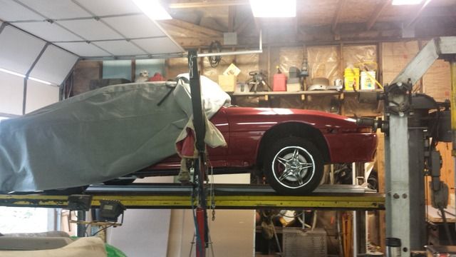

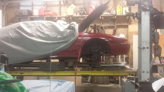

Been slacking on updates although I have slowly been making progress here and there. Finally was able to finish up putting up lighting and a few other things in the 4 post bay. Car is on the lift and blocked up, only getting one day a week after work to put towards the car atm.
I also started removing a few thing on the road to dropping the sub frame, tems, shock bolts, sway bar end-links, motor mounts. Unfortunately I could not find the 'key' to my gorilla lock lug nuts and had to order another. Not being able to get the wheels off halted progress a bit. Should be here any day so I can get rolling next time I make it out.

Got some work done on the car before/after the Hawks game yesterday.

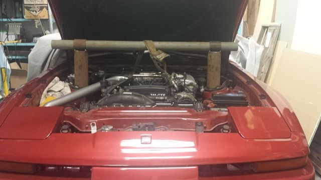

I threw this brake together for supporting the engine while I drop the sub frame. I had some old strut top mounts laying around which worked great.
I was able to get the motor to set up and give me about 3/4 of an inch on both mounts, so I should have no problem getting the sub frame back up.
Not much else to show but I received a replacement wheel lock key and removed the wheels, brake lines, calipers, rotors, steering shaft, cracked the upper/lower ball joint nuts and drained the ps fluid. The sub frame is ready to drop as soon as I figure out how to remove the abs sensors, I put some pressure on them and they did not want to move.
Going to try to get the subframe out later this week and begin the disassemble/cleaning process. Has anyone removed abs speed sensors before that can provide some insight?

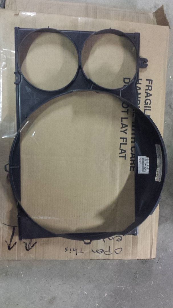

Had a few more parts show up. Snagged a brand new fan shroud off the forums, thanks steveaw11!

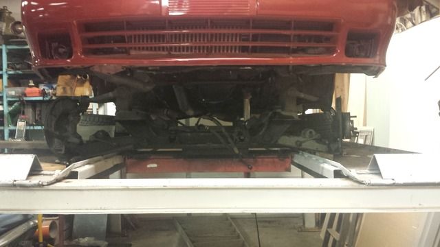

Made some progress last night. ABS sensor came out after hitting them with wd40 and twisting while making sure to only apply pressure to the metal bases. Also drained the ps fluid, removed the steering, shaft ps lines and misc other things that were still hooked up.
Finally was able to drop the front sub frame.

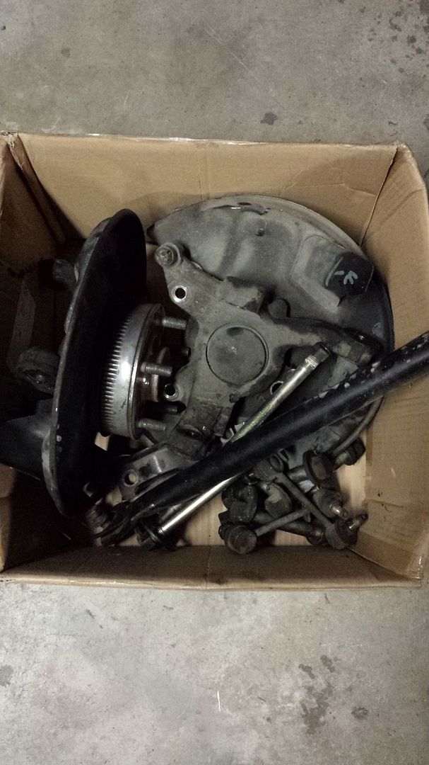

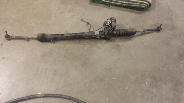

Pulled the rack to take home. Im going to media blast the exterior before disassembling it to keep contaminants out. I was hoping to also take the hubs homo degrease/prime+paint and the lower arms but the ball joints were being stubborn and it was late.

I was able to get the sub-frame out from under the car and stripped down. Seems like one of the common things I always see is people mentioning that you should always plan on purchasing new camber bolts and that its pretty common for them to have to be cut off. Mine came off easily with a quick hit with a rattle gun and and couple taps of a 2x4. They look great and had nearly zero corrosion. The Upper arm bolts were the same and the zinc/cad plating is nearly perfect.
Next step is to pressure wash the subrame and lower arms and pick up some gloss black epoxy paint. The bushings in the lower arms arent terrible but they do look their age. I am planning on pressing them out and ordering a set of whiteline poly bushings this week.

I also sand blasted my rack and its ready for fresh paint and to start disassembling. And I brought home a box full of other parts to blast and paint or powder coat.

Oh and not much new to report............did an initial cleaning on the hubs with a wire brush. Going to start on the swaybar links, camber bolts ect tonight hopefully. Little at a time.

Its my pops shop so I cant take much credit other than helping set a lot of it up. Mine is 20x24 with a 10 ft ceiling, his is 60x60 with.....18ft ceilings maybe, Thus why I chose to do it there despite having a 25 min commute.
He also has a 2 post lift in one of the front bays which would have actually been much easier to drop the sub frame but I knew this project would take a while and didn't want to tie up his main work bay.
