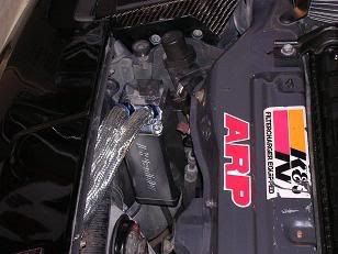

Found a nice spot for my Greddy can, but it will result in long hoses/pipes for the install, can you guys see any problem with that placement??

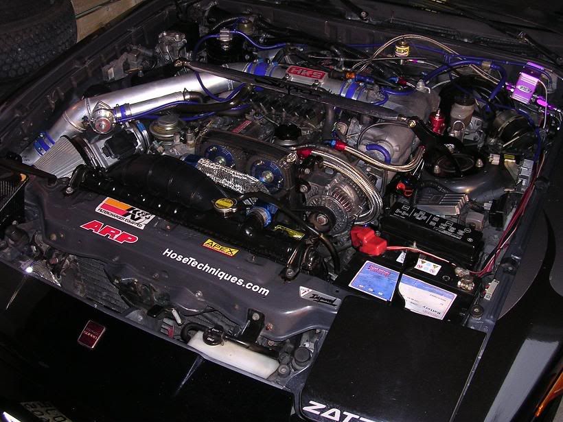

Have a bit of a search for catch cans, there are some post with pics, but heres mine anyway.

thanx, I have looked around just cant find any god spots without ending up with long pipes/hoses so therefore the question, but i probably hide it under somewere becouse I cant fit it nicely with short pipes/hoses in plain sight, and I wont put it near the turbo.

I was thinking about this for a while too.. I think, putting it in the front probably the best place to put it.. because it is the coldest area.. you want any carried over oil vapor to condense and collect.. also, make sure there is no low spots in your piping from the valve cover to the k/o can inlet.. ideally, the piping should have a high spot, such that it would be free draining to the valve covers and to the catch can..
